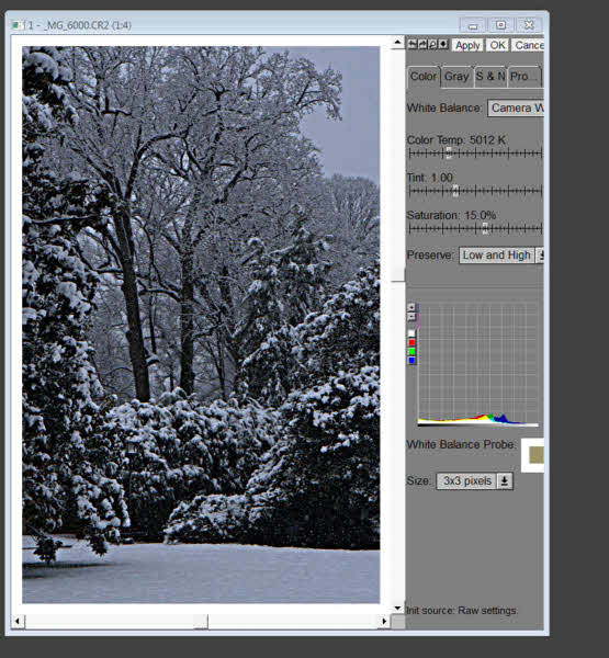

1. On my new Windows 7 (64) with a 2560 x 1440 monitor, with the operating system font size set at 125% (medium), the content of the raw conversion window runs into the right edge of the window, thus obscuring the rightmost 5% of the information. The problem is shown on the attached image.

Windows contents overrun window space
- window problem.jpg (68.57 KiB) Viewed 3904 times

Robert,
First, please make sure you are running the latest version -- PWP 7.0.11.
You can control font size in File/Preferences. You can also choose one of three widths for the Raw Dialog right panel in File/Raw Settings. It may be that for your monitor/font combination, you need to widen the panel. If none of the settings work in your case, please send me a screen shot at support@dl-c.com.

Thank you for your prompt reply.
Yes, I am running version 7.0.11.
Adjusting font size in preferences takes care of the problem. As long as the font size scale factor is 100% or less, the window contents fit within the window, but if the scale factor is larger than this, a portion of the right edge of the window contents is lost.
