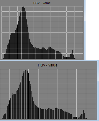

Depending on the font scale factor setting in Preferences the Histogram Tool shows irregularities in the grid. Upper image: scale factor from about 97% to 113%.
As the font gets larger, over 113%, and Histogram Tool box gets wider, the histogram inevitably stretches out with white gaps, however this can be misleading because the tool box is at its default width and cannot be made narrower. It creates an impression that the histogram is sparse even though the image has enough information in it. The lower image.
PWP 70.6. 64, Win 7 64.
Monitor Samsung SyncMaster XL20, resolution 1600 x 1200 (Recommended)

I have noted this too, running at fontsize 116% at a screen res of 1920 x 1080.
To my opinion it would be vey useful if the vertical "bars" of the histogram could be made wider when the histogram window is made bigger in width, so that there are gaps in the histogram just where actual gaps are, and not just because the "bars" are thin.
Another thing i would like to suggest for Histogram is the vertical scale. It is divided in 10 sections, but when the histogram is expanded the vertical axis is not linear anymore, could the sections follow this unlinearity ? Like on a logarithmic paper? So that at the bottom the distance is wider then on the top, accordingly to the expansion ?
It would be easier to read a expanded histogram, to my opinion.

Re: Font size and Histogram Tool
These problems have all been fixed in the next release.
