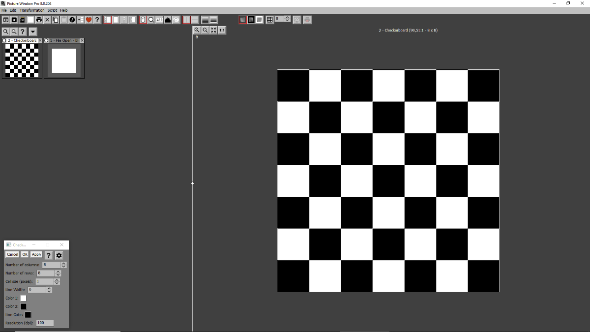

Scenario : create an 8x8 image, only 7x7 is shown.
2021-02-26 PWP8 8x8 off by one image area (only 7x7 shown).png (100.09 KiB) Viewed 6799 times

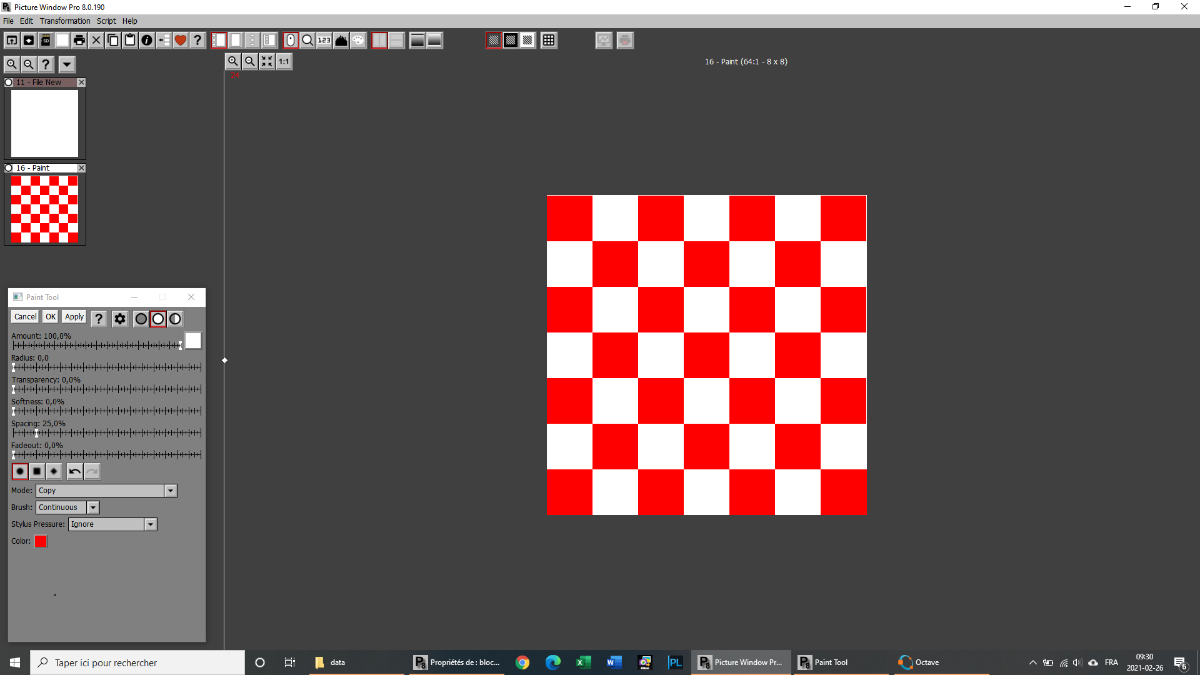

No ... the problem is still present in the latest version, 8.0.204
2021-03-14 PWP8 8x8 off by one image area (only 7x7 shown).png (62.42 KiB) Viewed 6743 times
Posts: 4883
Re: The image display area is off by one.
If you go to File/Preferences and set Smooth Display to Yes, it works OK. I will see if I can fix what is wrong for the other case for the next release.

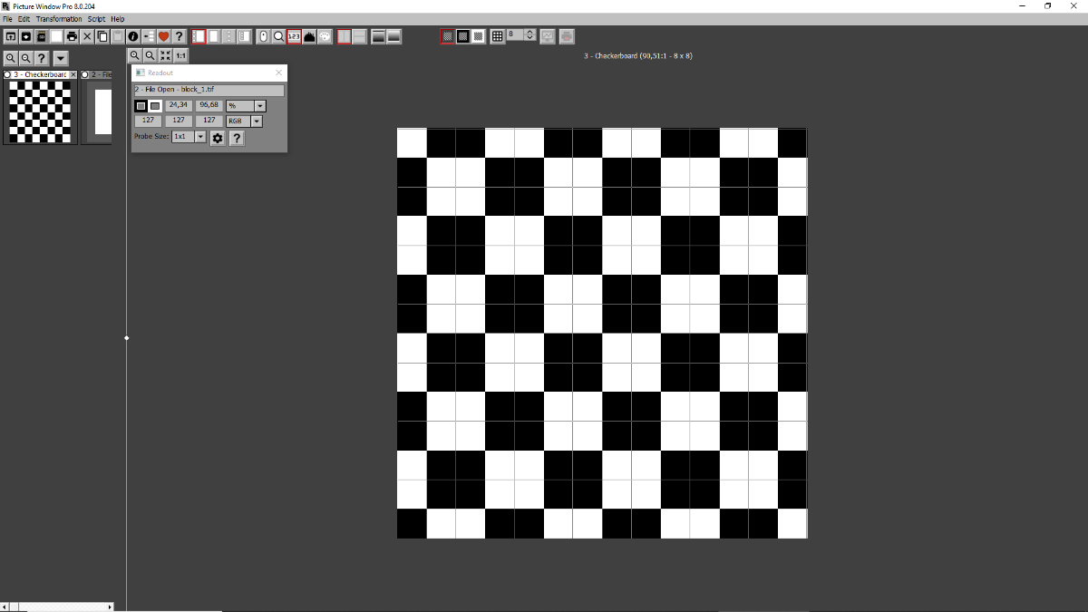

Hello Jonathan,
... not quite : using PWP8 with smooth scrolling : perimeter pixels not fully displayed (about half only).
and pixels are misaligned with an 8x8 grid.

This is not a bug. The pixel location is at the center of the square.
Posts: 744
I see that two problems remain :
1. 50% of the area of periphereral pixels is hidden, and 75% of the area of corner pixels is hidden.
2. In an image having 8x8 pixels, an 8x8 grid should align perfectly with the pixel boundaries. The resulting grid is not 8x8, as selected, but 7x7.
Thanks
Posts: 4883
The grid has 8 divisions and grid intersections pass through the centers of the pixels.
The display window is aligned with the centers of the pixels and thus shows only part of the edge pixels when you zoom in by huge amounts as in this example. This is a total non-issue for normal photographic images. While this may not be what you expect it to do, it is perfectly consistent and the way it works.
