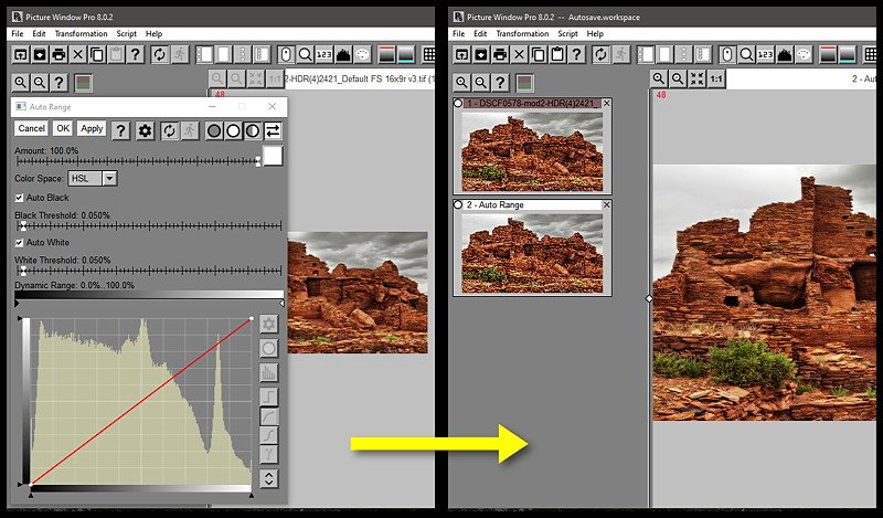

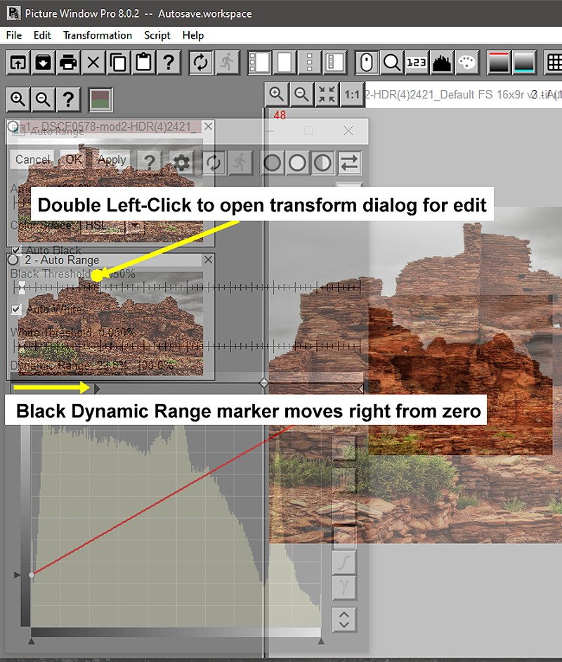

I use a laptop monitor 1366x762 pixels so that transform dialogs will easily cover browser images. In the case of Auto Range, when it it covers its Browser image and a double LeftClick near the title bar is used to open it for an Edit, the black Dynamic Range marker will un-intentionally move right from zero... ...Also noticed that the mouse icon will change from a single upper right pointing arrow to a double horizontal arrow depending upon the size and geometry of the Browser image space and the Dynamic Range bar of the transform dialog.
1) set File\Preferences\Initial Dialog Position: Lower Left
2) open an image in the Browser
3) open Gray\Autorange; set to FullRange; and OK
Screenshot (2).jpg (100.33 KiB) Viewed 45289 times
Increase Browser image size so that it is covered by the transform dialog upon a double LeftClick of the mouse.
The black Dynamic Range marker will move right when the dialog opens for edit.
