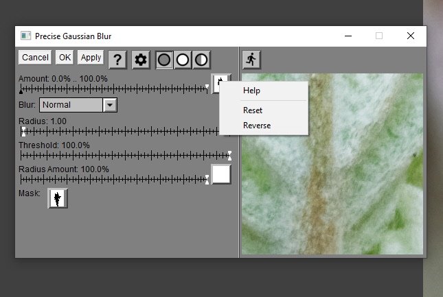

I have been fooled myself a few times by the missing Re-Open Mask Dialog item, but it is only displayed if the Mask dialog box is not already open. Sometimes it is out of sight or off to the side.

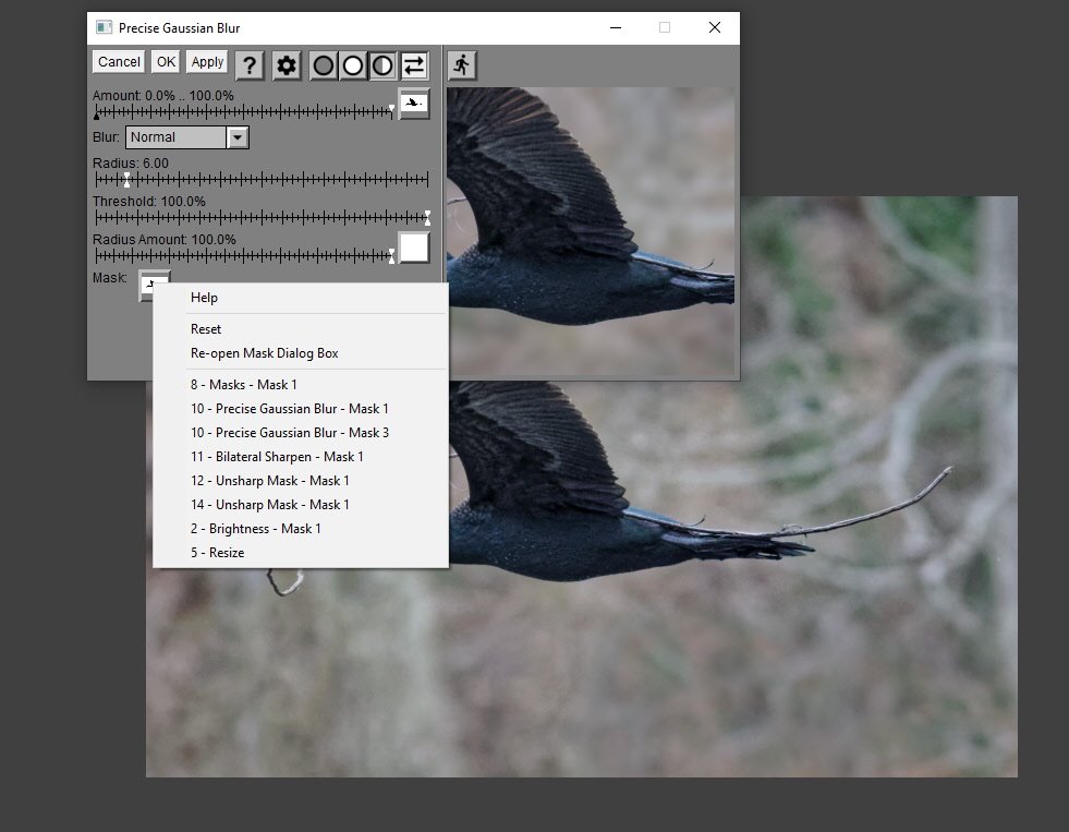

Here are screen shots of the wrong sized masks showing up in the Mask selection pull-down.
Here, the only properly sized mask image is "5 - Resize"

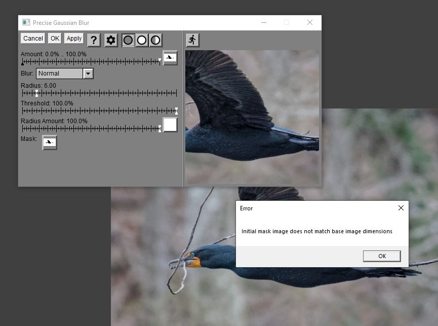

When "8 - Masks - Mask 1," for example, is selected an error occurs:

Not seeing the Edit Mask (Re-Open Mask?) option and no mask dialog box that I can find.

There was another problem I fixed with the Amount control, namely it is not supposed to display a list of mask images at the bottom of the menu unless the current amount is reset (i.e. when New Mask... is one of the options). This looks like it is the problem with your example since it shows a mask thumbnail in the Amount control. Once you select an image from the menu, things go downhill from there.
I will upload the new version tomorrow -- probably better to test with that version and see if there are any remaining issues.
