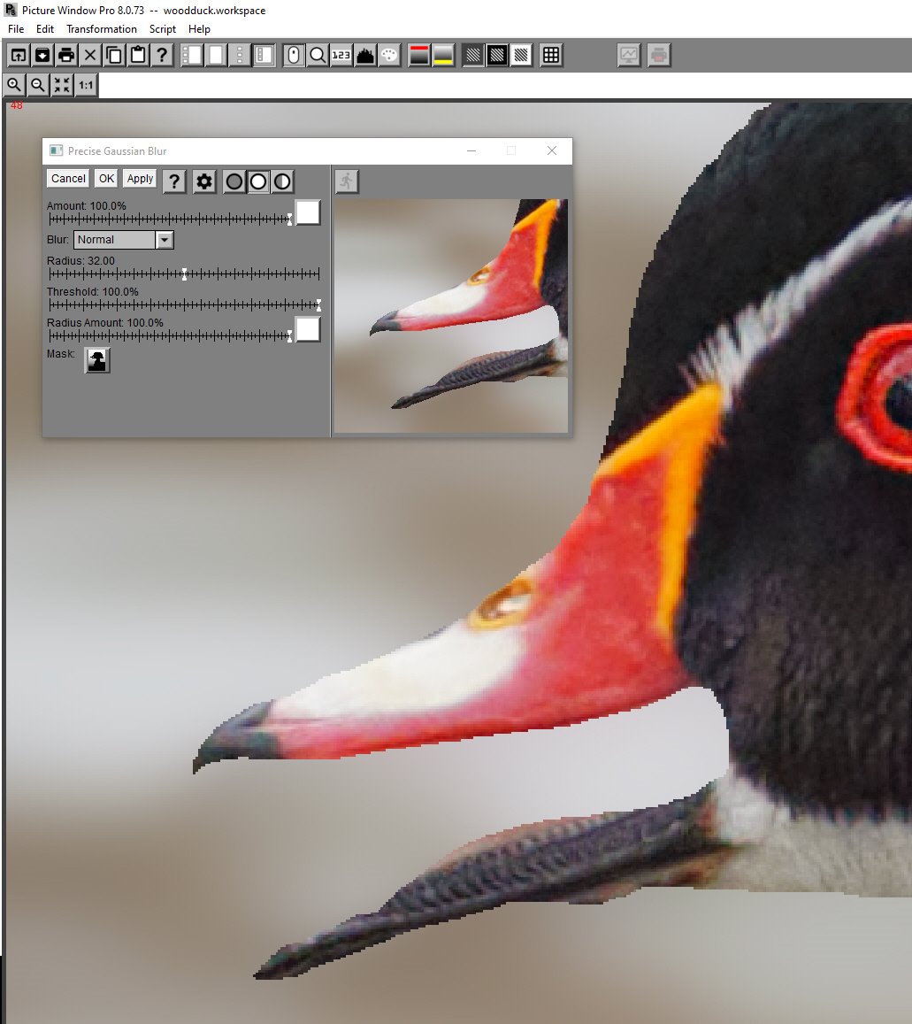

Mask Edit (aka Re-Open Mask Dialog Box) seems to be Missing for Precise G Blur Amount Mask.
See attachment.
Also, I always use the same mask for Amount and Mask. Is there a way to tell PWP to use one mask for both?

If you insert Masks transformation before Precise Gaussian Blur and set one or more masks there, they will be available for all mask buttons in Blur with 2 clicks.

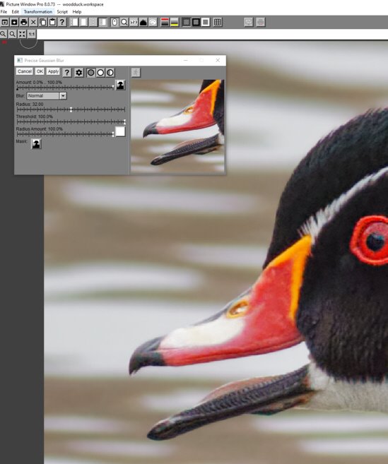

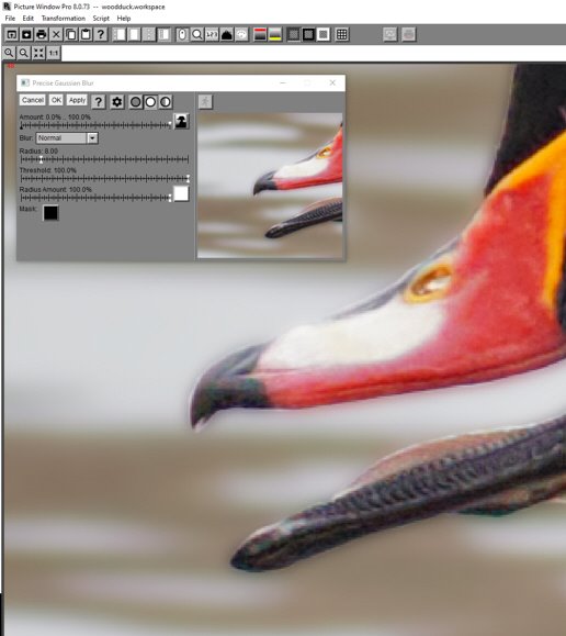

That doesn't seem to be the case. When just the Mask is used, there is edge erosion on the image. If just the Amount mask is used, there is a halo around the image. When both are used, all is good. See attached images. Don't know if there's a bug lurking here or not.

Do both of your masks have sharp edges (i.e. is the mask that you use in Amount feathered or blurred)?
Re: Mask Edit (aka Re-Open Mask Dialog Box) seems to be Missing for Precise G Blur Amount Mask
I did an experiment with sharp-edged masks and Precision Gaussian, and it does seem that the Amount mask uses antialiasing at the edges, while the Blurring mask does not.

The latest version 8.0.74 uses the Mask as the Amount if there is a mask image but no amount image.

tomczak wrote: March 28th, 2020, 3:11 am Do both of your masks have sharp edges (i.e. is the mask that you use in Amount feathered or blurred)?
Feathered mask edges.
