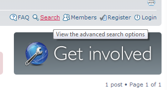

Re: Advanced Search of PWP Forums
Post by Dieter Mayr »
Kiril,
On the php site, in the support forum there is a "Advanced Search" function:
Offers a bunch of search functuions:
https://www.phpbb.com/community/search.php
