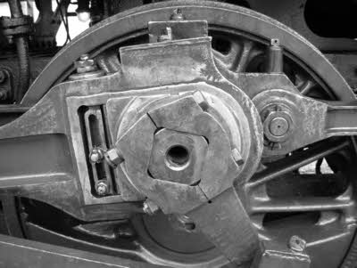

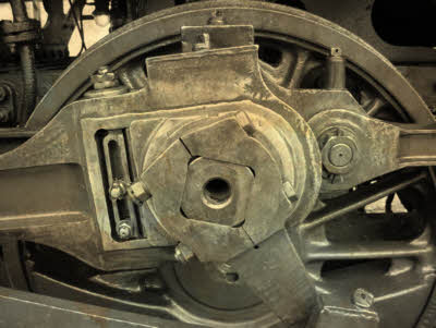

Bob, Kiril, a way I like to stain / age / tint images is the use of tea stained paper.
I use paper from a sketching block which is not so smooth and takes on the liquid well, and normal black tea.
I use either a brush for a uniform pattern or spilling some tea on the paper for irregular shapes, or placing a cup on the paper for a characteristic ring.
After the paper has dried I make a scan and use Composite with the Filter option to "age " and stain my image.
Below the original image, the paper scan and the composite result:
