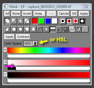

To add to Dieter's suggestion/question... ...perhaps one could skip the HSV-S or HSL-S channel Extract-ion altogether by simply using the Mask Tool - Color Range feature in either HSV or HSL... ...and move the S left white pointer slider to the right approximately 10% the length of the S color bar... ...then lower-left Apply Add to the image.
This would provide a mask of the 10 to 100 percent saturations [mask white] with the 0 to 10% saturations [mask black] protected from Hue changes. An Undo or None; re-position of the left S white pointer slider; and a lower-left Apply Add would increase or decrease the low saturation range adjusting the image's original neutral grays image areas to a preference...
