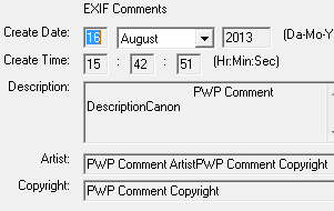

3) However, if the EXIF Description, Artist or Copyright are entered via Add Keywords (I added generic "PWP Description" "PWP Artist" and "PWP Copyright" to see what happens to them), they entries become scrambled (or distributed in the wrong fields, as shown). External EXIF viewers confirm it.

Add Keywords is intended to allow you to add comments to multiple images in a single use of the dialog. The idea is that frequently a whole series of images can be tagged with the same artist, copyright and even description.
In Browse, you select all the images to which a particular set of keywords, description, etc. apply, and then display the Add Keywords dialog. (It's invoked from the right-click menu.)
If you notice, each of the fields has the option of Add, Replace, or Default. These have the following significance: Add appends your edits to whatever else is already in the field. (This may be different for each of the images selected.) Replace overwrites the field with your entry. Default adds the entry if the field of a given image is blank and makes no change if the field is filled in already.
That said, there is apparently bug in the Add Keywords, so it currently does not operate properly. I will fix it for the next update. I would suggest not using it until it is fixed.
