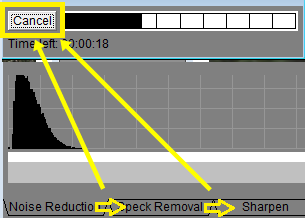

1)
If you move from any of the three tabs to next and click Cancel on the respective running status bar, PWP 7.0.8 32 on Win XP crashes.
2)
If you click Cancel on a running status bar while changing settings of any of the tabs - thus when not moving from tab to tab, it works as it should.
3)
if 2) is done first, 1) does not happen until Advanced Sharpen is closed and reopen.
4)
if Reset command is used, everything still works as it should, but when reset is done by closing and reopening Advanced Sharpen with Shift key, the problem described in 1) again reappears.

Just to make sure this post was not unfounded I tested it also with PWP 7.0.8 64 on Win 7 Pro 64 with the same result.
The step cannot be aborted and PWP 7.0.8 crashes.
