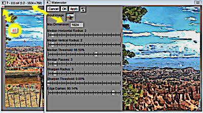

Noticed the following three items regarding Transformation/Special Effects/Watercolor... ...and wonder if these were intended...
(1) a 48-bit color Input image results in a 24-bit color transformed image upon an Apply or OK
(2) rather than a 'default' 2000 Max Dimension, would not the maxium dimension of the Input image be a better choice? with the understanding for visual element "detail" as provided from the F1 Help...
Step 1 - Resize
Before any other operations are performed, the input image is resized. This is done by specifying the maximum dimension (width for landscape or height for portrait) in pixels of the result image. Generally the image size is reduced in order to reduce the amount of detail in the image, but if the input image is already small, resizing it larger may also produce good results. The larger the output image, the more detail it will capture.
(3) an Apply/OK image version does not have an "Untitled N" format in the frame name prior to saving it to indicate that it is an "unsaved" work space image.

1) The algorithm for fast median filtering applies only to 24-bit images so 48-bit are converted to 24-bit.
2) The stroke detail is related to the image size - this would not work well for very small or large images
3) Will check this out.

(1) the resulting transformed image file size is the same as the 48-bit color Input image when the Max Dimension = the max dimension of the Input image... ...so I would conclude that though a portion of the transform calculations are 24-bit... ...the transformed image is indeed 48-bit and that this is a display issue similiar to item (3).
(2) understand the thinking here... ...just difficult to give up un-necessarily image data!!!
Re: PWP 7.0.7-32 -- Watercolor - ?'s
The output image is always 24-bit color - this is the way it works - it's not a display issue or a bug.
