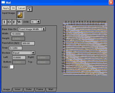

Mat & Frame preview comes out black
Post by davidh »
or mottled in PWP 7.0.6 32 on my nootebook with Windows XP 32. Tried various TIFs, JPEGs, PNGs, also bird.jpeg.
A mischievous notebook.
Mat and Frame.jpg (42.08 KiB) Viewed 8768 times
Posts: 4892
Re: Mat & Frame preview comes out black
Please try doing a Reset All from the Opt menu and let me know if that fixes the problem.
davidh
Posts: 843
Post by davidh »
Sorry no to mention it in the initial post. No reset helps to solve it. I also tried to restart the nootebook, close all other applications, etc.
davidh
Posts: 843
Post by davidh »
Jonathan, I have just uninstalled PWP 7.0.6 Beta 32bit and reinstalled the version PWP 7.0.5 Beta 32bit -> Mat & Frame preview is OK.
Posts: 4892
Finally found this bug. It only happens when you have your Monitor Profile (in Color Management settings) set to None and Color Management is enabled. Should be fixed in next release.
