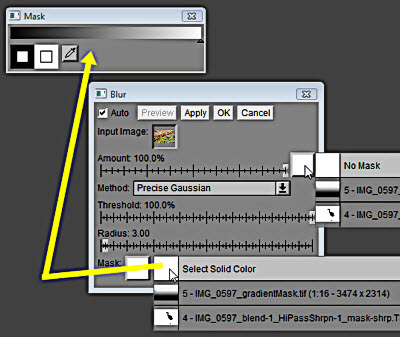

(1) Perhaps the lower left silhouette Mask top selection should be "No Mask" [automatic 100% white] rather than "Select Solid Color" which if selected initiates a Black/White Color Picker dialog that will remain in the work space until closed.

(1) what is the purpose of the Mask BW Color Picker dialog if one clicks on "Select Solid Color" in the lower left silhouette Mask drop downs? This dialog will stay open in the work space until it is manually closed. Should not this be the same as the Amount Mask "No Mask" selection, ie, the dialog flashes then closes?

I fixed the "No Mask" problem.
