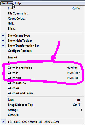

(2) NumPad *,-, and + are available for an 'active' workspace image:
