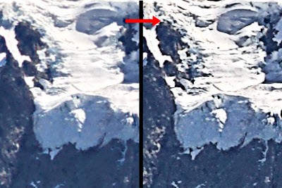

Illustration 1 (1:1 Zoom Factor):
...where a USM Radius =10 was used on a High Pass Filter image where its Radius =3; then Composite-Hard Light HSV-V blended...
Note: "Composite-Hard Light HSV-V blended" just means the mask image generated with the Mask Tool - Brightness Curve default curve was used as the Overlay image in the Composite-Hard Light blend as well as its own Overlay mask. By doing so, color artifacts were greatly reduced and the white/black halves of sharpening could still be adjusted to reduce objectionable white half sharpening.

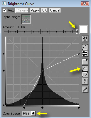

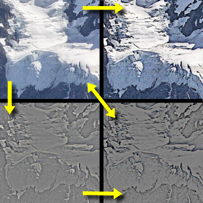

I have been experimenting with High Pass Filter image modifications that might be good for generating High Pass sharpened images that decreases the light half and increases the dark half of an image's edge contrasts, yet potentially adds significant image detail...
For the following illustration, go CCW starting with the upper left 200x200 pixel, 1:1 image crop of the Starting image...
Step(1): Open or select a Starting image [8-bit or 16-bit; Black/White or Color] that is near preferences for: (1) dynamic range; (2) brightness; (3) contrast; (4) color; (5) sharpness; and (6) noise...
Step(2): Open the "Tranformation | Sharpen, Blur, Noise | Blur" transform; OK settings: Amount =100; Method =High Pass; Threshold =100; and Radius =3 or a preference...
Step(3): Open the "Transformation | Gray | Brightness Curve" transform; OK a RGB Broken Line curve =[0,0], [0,25], [50,50], [100,75], [100,100] with Amount =100 on the resulting Step(2) image...
Step(4): Open the "Transformation | Composite" transform where the Input Image =the Step(1) Starting image; Overlay =the resulting Step(3) image; Operation =Soft Light [generally the best choice] or Hard Light; and Alignment =none. Initially start with Amount settings for the Input Image and Overlay =100; decrease the Input Image Amount to a preference [perhaps 50 to 70% if Hard Light Operation is selected]... ...click OK, creating the High Pass sharpened image.

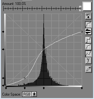

The suggested RGB Brightness Curve in text form [PWP6]:
Curve 1.0
npts 3
style linear
histexpand 0
point 0 64 0
point 1 128 128
point 2 255 191
end
Have some fun experimenting... ...try as I might, I could not achieve objectionable light half sharpening edges... ...black specks from existing image noise is a different story... ...but that is where one switches from Hard Light to Soft Light and adjusting the Input Image Amount... ...or perhaps 1:1 cloning or specific image area blending of Hard Light and Soft Light image versions...
...ask if there are questions...
...den..

Further experimentation has indicated that using the following Step(3) RGB Brightness Curve will result in less intense black specks and still provides added bias to the dark half and less bias to the light half of sharpening edge contrasts when using High Pass - Soft or Hard Light sharpening methods...
In text form [PWP6]:
Curve 1.0
npts 4
style spline
histexpand 0
point 0 0 0
point 1 64 26
point 2 128 128
point 3 255 191
end
Additional HINT: Steps(1-2-3) can easily be retained in History once done for an image during a PWP session... ...and/or saved as an image with associated wfl for furture use.
