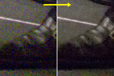

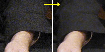

Then using the image examples from Ref 1, the following results were obtained after several trials where the complete settings were not recorded:
Example 1: 1 pass [NLM-std denoise]
Example 2: 2 passes [DCT-color denoise + NLM-std denoise]
Not necessarily for the 'faint of heart' but the results look promising and the price is right [free].
