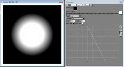

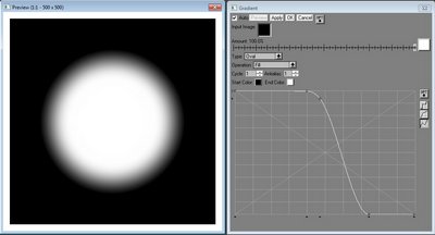

Hmm, no takers! (PS. Ah, I see that there is now a reply from John) Well, perhaps I am a lone voice, but by way of illustrating what I mean, here are two recreations of the clone disk. The first image shows what I am asking for. I would have thought that this profile would give a more subtle blending than the existing situation, since there is no hard edge to the central disk. The second image is meant to represent the existing situation, with what I assume to be a linear fall off.

- Clone profile 1.jpg (19.08 KiB) Viewed 14476 times
- Linear softness
- Clone profile 2.jpg (19.22 KiB) Viewed 14466 times
