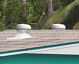

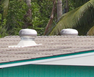

An example of restricting major halos, in addition to AS.
- AS Sharpened + roughest edges reduced
- 3ASharpenedMasked.jpg (42.6 KiB) Viewed 7882 times
- AS Sharpened
- 2ASharpened-1.JPG (47.26 KiB) Viewed 7894 times
- Unsharpened RAW
- 1Unsharpened.jpg (32.46 KiB) Viewed 7881 times

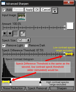

I have finally figured out what the two threshold sliders in AS/Speck Removal actually do, and thus how to use them properly, and I'm so happy about it that I decided to share it with the rest of the world!
It's best explained with a simulated screenshot:
- The Speck Difference Threshold slider exclude specks in the lowest contrast range; this is identical to having an (imaginary) second threshold slider under the histogram instead.
- The existing 'glued-triangles' Threshold slider under the histogram exclude specks in the highest contrast range
Effectively, the AS (but only the Speck Removal tab) already has a dual (hard)threshold logic that allow to isolate and deal with specks of any contrast range, by controlling what's excluded from both tails of the histogram.
- AS_SpeckThreshold.png (21.34 KiB) Viewed 7774 times

I downloaded the "Unsharpened RAW" image and have tried various Speck Removal and Sharpen tab settings to duplicate your AS examples...
Is there a combination of settings that does not produce the single bright pixels yet minimizes halos and retains sharpness?

Den,
I'm not sure what settings I've used anymore, I'll experiment again and let you know.
The whole idea was to show, as a proof of concept, that if AS Sharpen (and perhaps Blur) tab had the ability to restrict blurring/sharpening to both ends of the roughness histograms, that would make AS much, much more powerful, without having to change much of its logic!
All I've done is to use Sharpen Tab only, and simulated nonexistent high roughness thresholding slider (to reduce sharpening and thus halos on rough edges) by using a Texture mask that was thresholded (and blurred a little) so that only rough edges were covered (Average Difference seems to work best).
The white specs are probably the result of too small radius and too high sharpen amount, without much room in the highlights to accommodate sharpening white overshoots - sharpening was admittedly overdone to illustrate the concept.
But incidentally, this is a good example for practicing the thresholding in Specks tab (see above for how it does it). The Speck Difference Threshold (lower threshold) and the Histogram threshold (higher threshold) sliders need to be adjusted so that only the specks are shown in the Difference view. Since the specs were pronounced (or produced) by sharpening tab, it may be actually easier to isolated them with Speck Removal by running AS again and using only the Specks tab.

Thank you Maciej for the expanded explanation.
I was trying for a single AS transform application to achieve the "AS Sharpened+roughest edges reduced" look without the bright pixels but when their frequency was included in the Speck Removal tab or by extending the Sharpen tab fader (white slider) further away from the black slider... the Preview became too soft...
I could easily clean up the bright single pixels with a second AS-Speck Removal application; or PWP6 Noise reduction or the Bilateral Sharpen transforms set for skin smoothing settings...

It's quite possible that with true dual threshold in AS/Sharpen tab, those white specks could have been excluded from sharpening in the first place. The texture Mask simulating the upper sharpen threshold, especially blurred, probably had missed them. It is finicky a method, presently.
