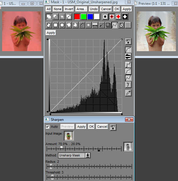

I tend to control sharpening edge undershoot/overshoot with an 'active' default Mask Tool - Brightness curve applied to either the 'starting image' or its Luminance channel... ...then use that mask interactively with whatever sharpening transform being employed... ...Mask black amount controls the edge undershoot and mask white amount controls the edge overshoot based upon the image's globally mapped HSV-Values or Luminance gray tones...
The attachment below illustrates USM where the undershoot edge sharpening is set to a 70% amount preference with the overshoot edge sharpening set to a 20% amount preference to eliminate objectionable white major edge halos... ...preferences are set while viewing Preview at 1:1 Zoom image areas to avoid anti-aliasing artifacts.
Note... I favor the 'active' Luminance channel mask as most sharpening methods occur in the RGB color space as is the case for USM... ...but this is a nuance that will generally go un-noticed for most photo-realistic images.
This may be a more direct equivalent approach then a Composite-Darken, followed by a Composite-Lighten transformation sequence where an over-sharpened image version of the 'starting image' is used as the Overlay.

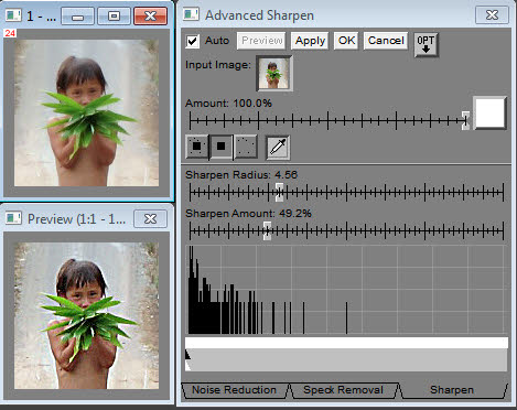

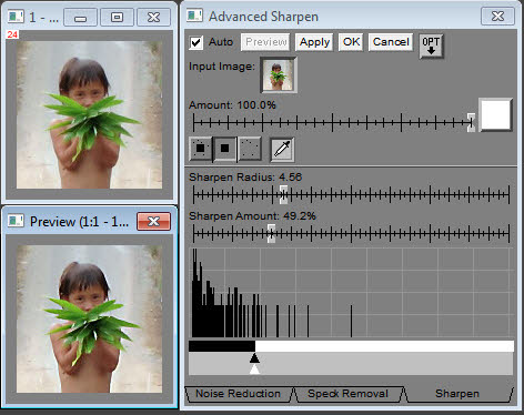

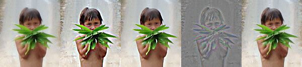

Here is an example of trying to reduce major edge halos in AS. In effect, this technique tries to sharpen only lower (or middle) roughness ranges and protect the major edges from sharpening (and thus prevent or reduce the associated dreadful major halos).
The method is a little laborious and not quite interactive - which makes adjusting sharpening parameters and thresholds a bit of a guesswork, but I think it is quite an improvement over either masking the major edges (which may not get the right, halo-producing edges or mask too much and degrade sharpening effect) or Den's brightness gradient masking (which may affect global sharpening by brightness, regardless of edge roughness). The reason that the roughness - major or minor - has the same AS-definition and allows for smooth transitions between sharpened and unsharpened elements of the picture.
It works by:
1) AS sharpening the image with no threshold (or with some lower threshold to exclude noise from sharpening)
2) AS sharpening only the major edges by moving the lower threshold sliders to the far right of roughness histogram
3) Subtracting 2) from 1), thus leaving only lower roughness over/under shoots
4) Compositing the original, unsharpened image with the 3) in Soft Light mode.
p.s. AS, unlike Bilateral Sharpen, can use soft roughness thresholds (by separating white and black threshold sliders) to further improve the appearance of the sharpened image. Hard thresholds were use in this example. Sharpening and threshold parameters used are probably not ideal, but sufficient to illustrate the technique. Both white and black halos on major edges are reduced - targeting only the white overshoots can further optimize the sharpening, but, if done by hand, further complicates the technique.

- Original --> AS sharpened all --> AS sharpened major edges only --> Offset difference between AS1 and AS2 --> Composite of Original with the AS difference in Soft Light

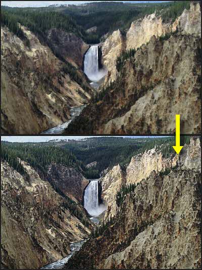

(4) My preference is not so conservative as Maciej's so I prefer to use a Composite - Hard Light blend with a reduced amount that would normally be applied if Soft Light were used.
Does this technique work? Indeed it does... ...in the following illustration, a 3456x2304 pixel image of the Lower Yellowstone River Falls & Canyon was Resized using the Bicubic method to a width of 400 pixels [top image] which of course was softened... ...Maciej's Advanced Sharpen-Sharpen technique was employed with settings suitable for the 400w pixel image resulting in the bottom image with no objectionable dark/white edge halos and fine detail restoration......It is really difficult to fully appreciate the improvement at message board posting resolutions for full sized image... ...Be sure to try this yourself and pixel peek an image on your own monitor...
Thank you again Maciej...
