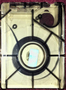

Is it possible (within Picture Window Pro 5.0, or do I need to use something, like Photoshop) to rotate this photo in three dimensions, such that, it would look as if the camera were directly over top of the subject. If it's possible, can someone please tell me how to use this software to do it, or if this has already been covered, can I please be directed to the relevant posts, on this board, that would accommodate this chore. If PWP isn't suited to this task, are there any recommendations, on what I could use to get the task done?

Use Warp transformation to do that (Transformations/Geometry/Warp...). With the mouse, drag the four corners of the gridded rectangle so that they align with the corners of your object in the picture. making the sides of the gridded rectangle parallel to the sides of your object in the picture. Watch in the preview what the transformation will produce. Adjust Proportions and Scale Factor sliders, if necessary, to minimize distortions. Hit OK.

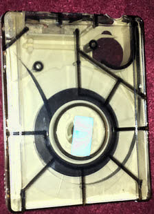

Thanks so much guys, for the reply. I have yet to try the technique of the second poster, but the first technique seems to work very well.
