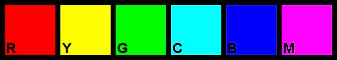

Attached is a simple workpsace (renamed as .txt) that shows the issue on the last brightness curve xform. I used one of the test images included in PWP

I'm not at my photo computer right now, but the image was one of the PWP test images. It had RGBCYM squares. I converted it to
a 16 bit TIF file for my tests.
I can look for the name tomorrow. It's weird - I drag & dropped it and the message shows it as an attachment.

I have attached a revised workspace file and a jpeg of the color_spin test pattern.
1) start the workspace, then when it prompts you for an image, use the attached jpeg file.
2) go to transform transform #5, the 3rd brightness curve (second one with a mask) and open it.
3) edit the mask
4) try to change the blur radius or feather width via the scroll bar. Both fail to change the value displayed.
This is on the most recent (481) release. Note that I am running Win 8.1
Note I have changed the workspace name to end in .txt so the upload works
I hope this helps.
John P
