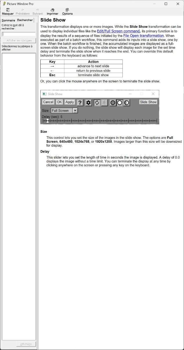

Re: 8.0.465 problem : slide show
Help for Slide Show transform :
Yes, I saw that after I posted -- have added arrow and esc support to slide show for next release.
