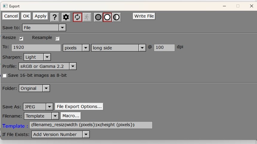

Here is what I found during initial trials :
about Macros :
  • I could not find a macro to extract the filename without the ".extension" suffix. Suggestion : include a separate macro that reflects only the file name without the extension
  • When macros are used in an Export transformation with the optional resize enabled, the width and height macro expansion does not reflect the resize operation. Suggestion : get the attributes of the resulting image rather than the input image.
about File Export transformation using a template for the filename:
  • I could not define a long template text such as ⟪filename⟫_resized_⟪width (pixels}⟫x⟪height (pixels}⟫, because the data entry box lack space for such long text. Suggestion : data entry box should have capacity to accept much longer templates
  • The help button in the File Export transformation dialog box opens a help page which is missing most details found in the online help file. For example the capability of Templates for generating a file name.
  • In the section of the File export transformation, the online help file is missing the description of the settings menu.
  • The dialog box when using macros could be clearer if the label read "Template" rather than "File Name"
    2023-11-26 File Export Dialog.jpg (49.07 KiB) Viewed 2675 times

For the next release, I fixed the problem with filename including the extension and added a new macro to get just the extension.
The template entry field now expands when you resize the dialog box and it autoscrolls horizontally to accommodate long entries. There is a size limit on pathname of around 256 characters, so you need to be a little careful.
