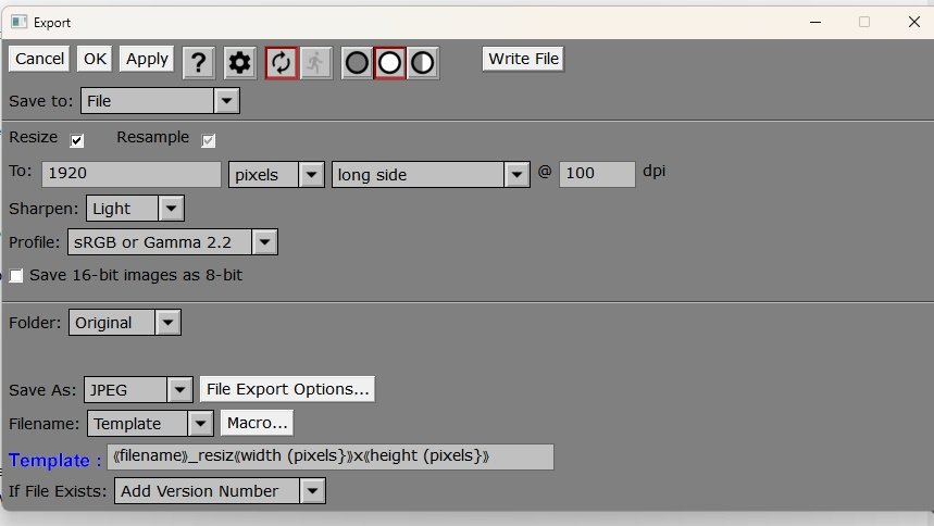

about File Export transformation using a template for the filename:
  • I could not define a long template text such as ⟪filename⟫_resized_⟪width (pixels}⟫x⟪height (pixels}⟫, because the data entry box lack space for such long text. Suggestion : data entry box should have capacity to accept much longer templates
  • The help button in the File Export transformation dialog box opens a help page which is missing most details found in the online help file. For example the capability of Templates for generating a file name.
  • In the section of the File export transformation, the online help file is missing the description of the settings menu.
  • The dialog box when using macros could be clearer if the label read "Template" rather than "File Name"

For the next release, I fixed the problem with filename including the extension and added a new macro to get just the extension.
The template entry field now expands when you resize the dialog box and it autoscrolls horizontally to accommodate long entries. There is a size limit on pathname of around 256 characters, so you need to be a little careful.
