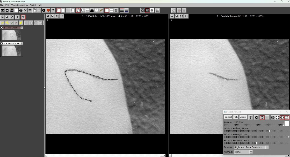

The scratch removal tool did not completely remove a scratch.
I used the tool as shown below :
Capture d’écran 2023-08-07 115640 v1.jpg (120.57 KiB) Viewed 892 times
Source image :
1956 Robert bébé 001 crop v1.jpg (121.25 KiB) Viewed 892 times

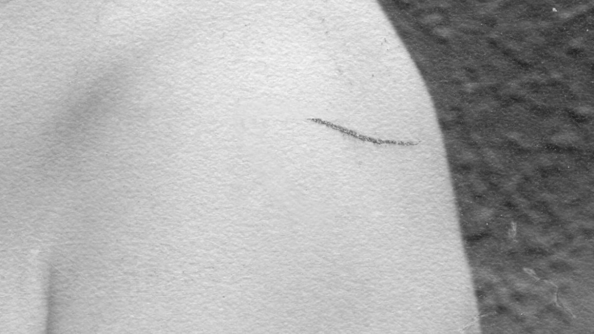

Output image :
1956 Robert bébé 001 crop v2.jpg (119.7 KiB) Viewed 892 times

Posts: 4876
Re: scratch removal tool problem - incomplete removal
Fixed for next release. The problem only shows up in cases where horizontal scan lines intersect the scratch removal polygon in multiple segments, so the workaround for now is to remove the scratch in separate sections.
In any case, the Clone tool does a better job on this image and is just as fast to use.
