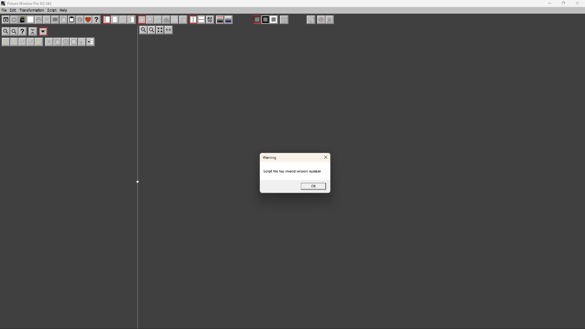

Whenever executing a script, PWP displays the message "Script file has invalid version number"

A screen capture of the error message follows.
2023-01-09 script test - invalid version number.png (46.8 KiB) Viewed 1793 times
