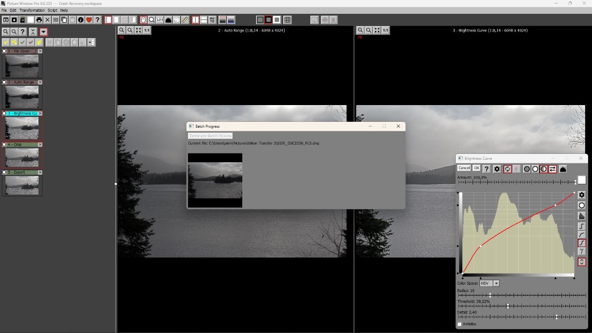

Crash happened again and is repeatable:
  • Terminate batch process
  • Press ok on the current transformation (the transformation control panel "brightness curve" is still in view)
2022-12-01 PW8 crash upon terminating batch v1.jpg (94.43 KiB) Viewed 1896 times

While I was unable to get it to crash here, this is clearly a scenario I did not contemplate originally so it does not fail gracefully. For the next release terminating the batch job cancels out of the current transformation, if any, and returns you to the File Open that initiated the batch job.
