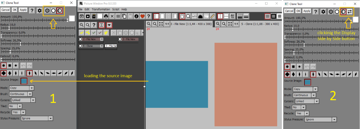

Re: Clone with Synchronized scrolling OFF
Version 8.0.333
Let me answer separately.
The following is a kind of cosmetic one.
You wrote: If there is an auxiliary input image whose size is not the same as the input image, synchronized scrolling is never allowed.
Yes, Synchronized Scrolling button is hidden when you load an auxiliary image, but it can still be displayed by clicking on Display Side by Side button.
Image 1: source image is loaded -> Synchronized Scrolling button is hidden, Display Side By Side button is pushed in, default - OK
Image 2: you are still allowed to click on Display Side By Side button to display Synchronized Scrolling button - clicking on it should have no effect
- Synchronized scrolling.png (153.15 KiB) Viewed 4754 times

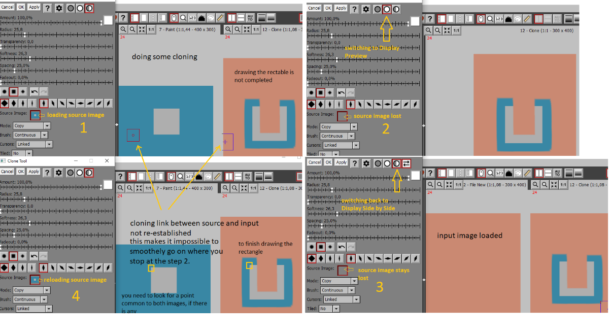

The second part - regarding the scenario 3. S
The second part is a bit more difficult to describe.
And even more difficult to implement, I guess. It even might not be worth it.
The bottom line is that switching previews removes the source image thus breaking the established cloning link which is not re-established after the source image is reloaded.
If there is no clearly defined point common to input and source images, it may be impossible to smoothely reconnect where you finish cloning before swithinchg previews. See the attachment. Read the images clockwise.
image 1: loading a source image and doing some cloning without finishing it - the rectanle is not completed.
image 2: display is switched to Preview -> this removes the source image and breaks the cloning link
image 3: switching display back to Side by Side just displays the input image - the source and the link are not there any more
image 4: reloading the source image will not re-establish the lost clone link to the state before switching preview (image
Some suggestions:
Perhaps switching previews should not automaticaly remove the source image and break the clone link. This could be done by user instead.
What I mean is that switching previews should not do the same as changing source images.
If user decides to change the source image before they finish sourcing the current one, it is their decision. But perhaps not by switching previews.
Or, from another, purely theoretical, point of view; when cloning, what is the use of having the other two display options when you can clone from the input image itself - no need to remove the source image.
This brings me to answering my own question: what if clicking on other then Display Side by Side button simply did nothing?
let me repeat this all regards only the scenario 3: The source image is not the input image and is not the same size as the input image.
Some suggestions:
- Clone with switched Previews.png (279.32 KiB) Viewed 4754 times
I made the change to retain the Source Image setting when changing the display to output-image-only. This seems to work OK as you can still clone from the source to the output image even though the source image is no longer visible. Since this does not seem to cause any problems, I will leave the change for now. If any issues come up I can always put it back the way it was.
Nice solution.
Thank you.
Thank you.
