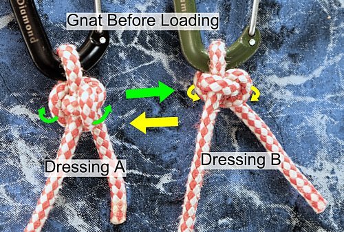

Here is a little project with the intention to illustrate that one form of a knot can be easily transformed into another, and back (green and yellow arrows). I was thinking that it would be even more intuitive if the big 'transformation' arrows were not one green, one yellow, but have the yellow to green gradient (or vice versa). I can probably try to do it with a mask shaped as an arrow and the Composite with the appropriate gradient, but it sounds like a lot of work...

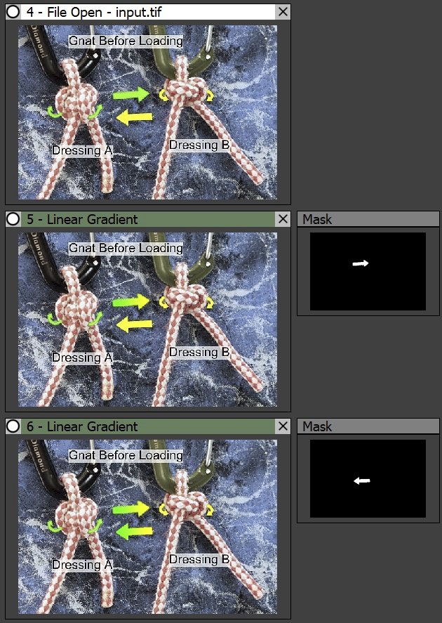

I was able to quickly make a mask for each arrow using the Flood Fill tool. Once you have the mask, the Linear Gradient transformation can create the gradient where the arrow was.
Here is the workspace script using the image from your post:
