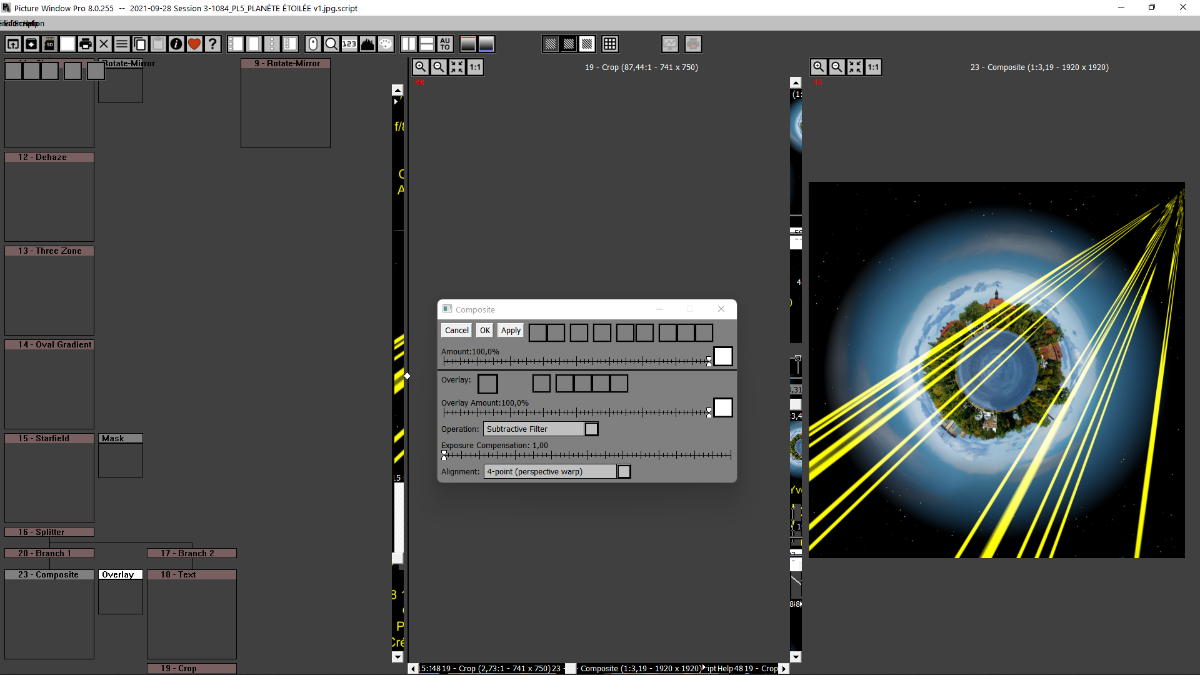

During usage of composite tool, 4-point warp adjustment went berzerk.
2021-12-06 Composite berzerk.png (304.54 KiB) Viewed 1492 times
Most data disappeared from the dialog box.

There are singularities in doing a perspective warp if you place control points right on top of or extremely near each other. I do have code in place to check for this case, but apparently it is not foolproof. If you use the transformation normally, this situation does not occur.
