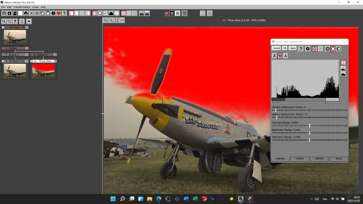

Re: Transformations with thresholds : feathering to smoothen transition artifacts

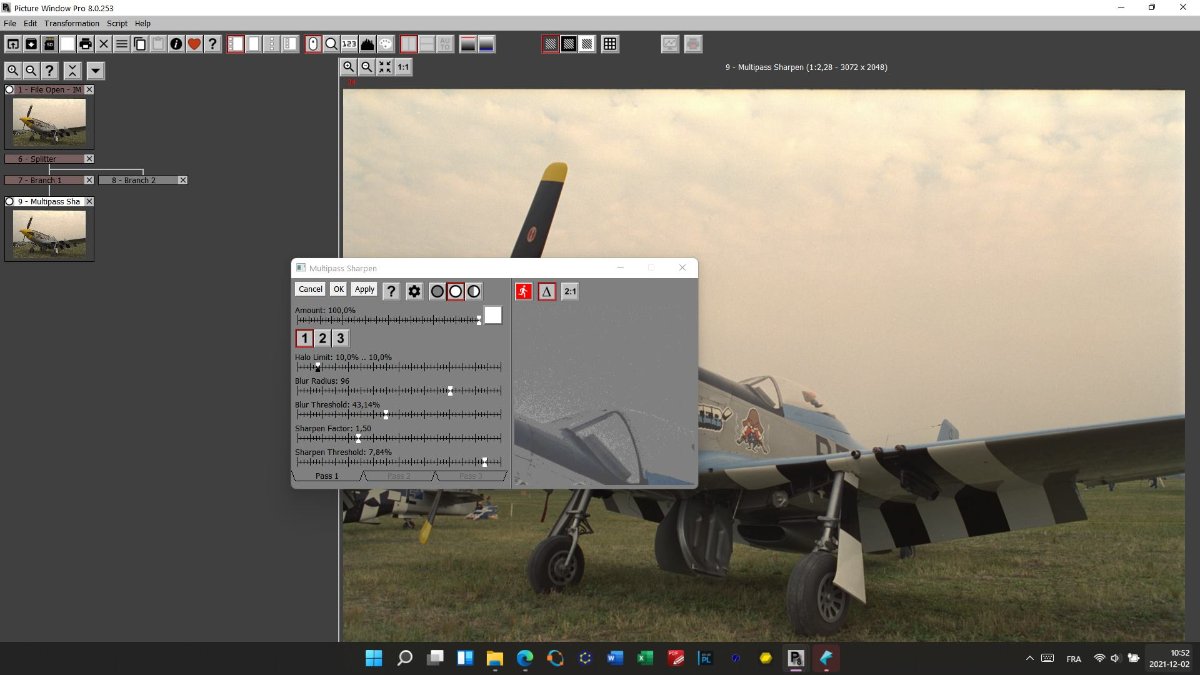

I was thinking of feathering or blurring as found in the Gray Zone transformations.
Multi-pass sharpening
2021-12-02 Multi-pass sharpen grainy artifacts v1.jpg (105.46 KiB) Viewed 2006 times

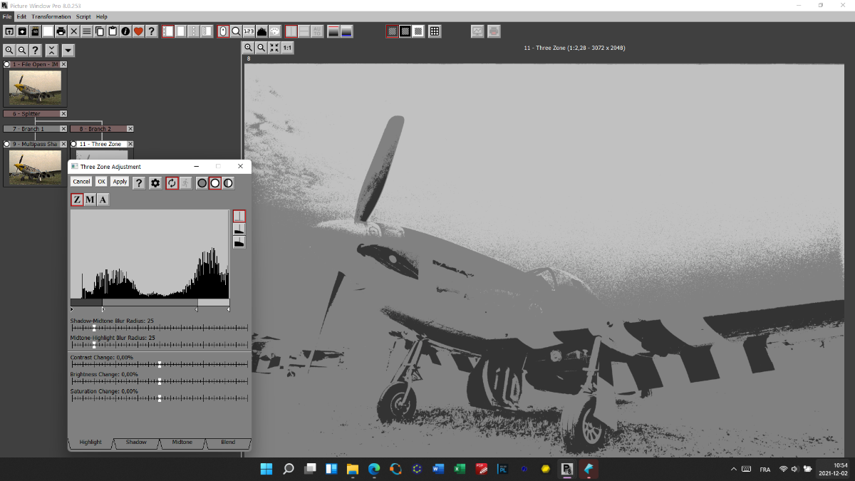

Three-zone adjustment
Before blurring, the transitions are grainy.
2021-12-02 Three-zone adjustment with grainy artifacts before blurring.png (302.12 KiB) Viewed 2006 times
After blurring, the transitions are smooth.
2021-12-02 Three-zone adjustment, after blurring, without grainy artifacts v1.jpg
2021-12-02 Three-zone adjustment, after blurring, without grainy artifacts v1.jpg (108.59 KiB) Viewed 2006 times

Actually, if the goal is local area contrast enhancement to a soft-textured area such as a cloudy sky, I expect that textured-based masking will be of little help.
Also consider that the area of interest is defined by blurring and sharpening thresholds, so a mask will have to be re-done whenever the threshold sliders are adjusted.
