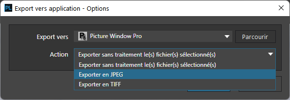

In DxO Photolab
the user simply selects "Export to application", and the interface allows the user to add applications to a list of recently-used applications. No special setup is required prior to use.
DxO's user interface for exporting to an external application is shown below:
2021-12-02 DxO Photolab interface to applications.png (15.89 KiB) Viewed 4961 times
The list of previously used applications is stored in a user.config file. For example, an excerpt of DxO's Photolab user.config contains data for exporting to PWP8 and Microsoft ICE:

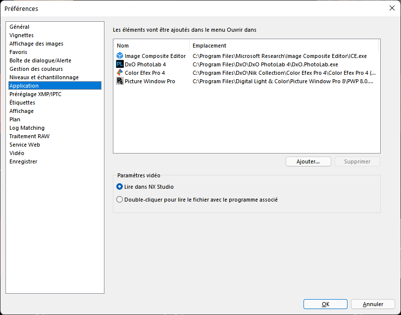

In Nikon NX Studio:
the user can declare the applications in user preferences as shown below:
2021-12-02 Nikon Studio interface to applications v1.png (42.71 KiB) Viewed 4961 times

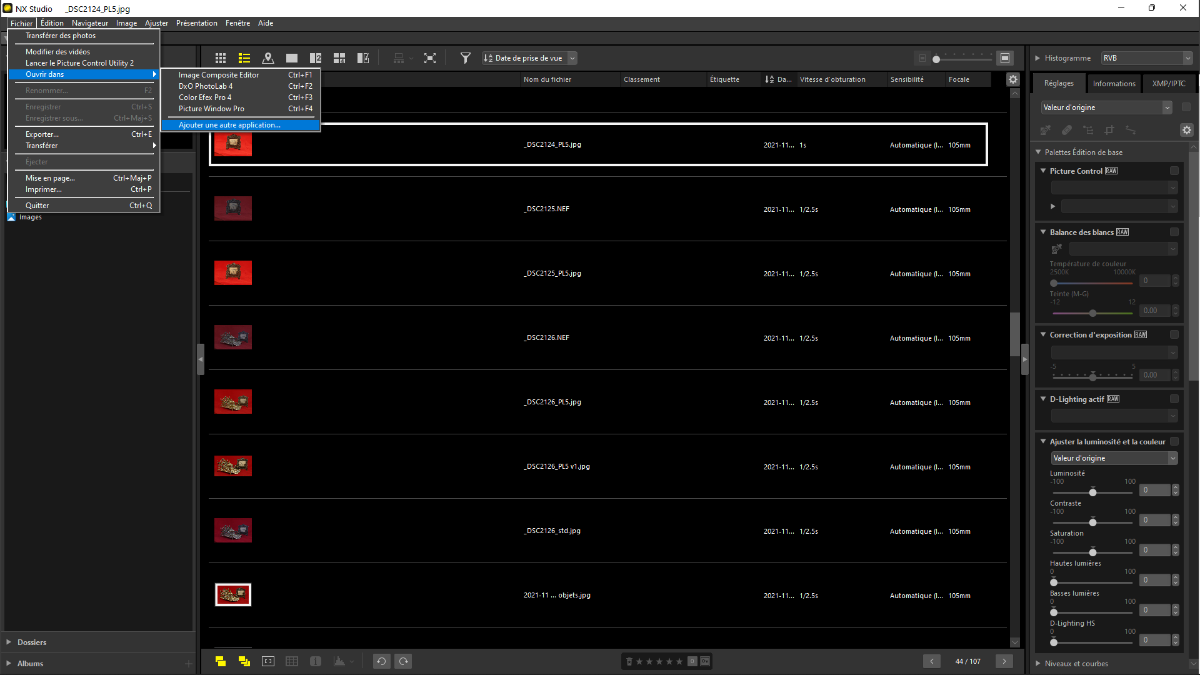

Also, an application can be added on the fly as shown in the screen capture below:
2021-12-02 Nikon Studio interface to applications (menu).png (144.12 KiB) Viewed 4960 times
