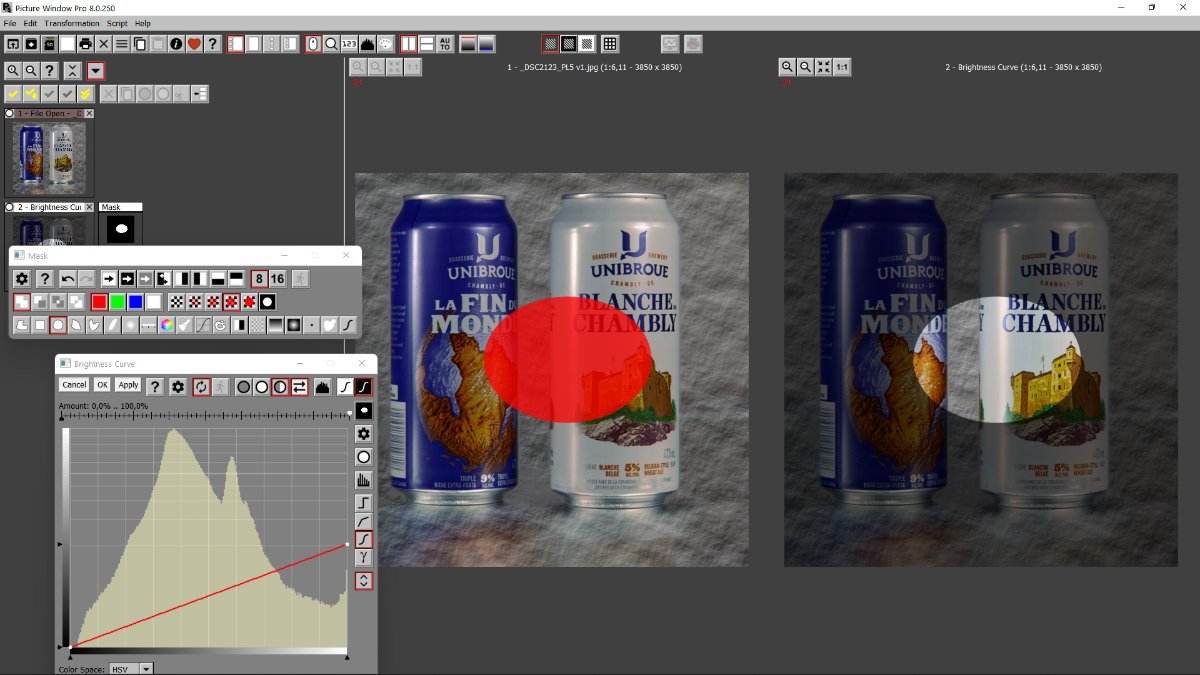

I agree with those statements, but it is not how the specific curve is implemented in the Brightness curve tool ....
Using the screen capture for discussion.
In PWP 8.0.250, the black marker must be set at 0% for effectiveness where the mask is black. This is contrary to PWP8's usual convention. I was expecting opposite marker positions for the Brighthess curve tool when selecting "curve for areas where mask is black". Thus black should be set to the far right for effectiveness in the black area of the mask. The value should read 100% when the black mask is fully effective.

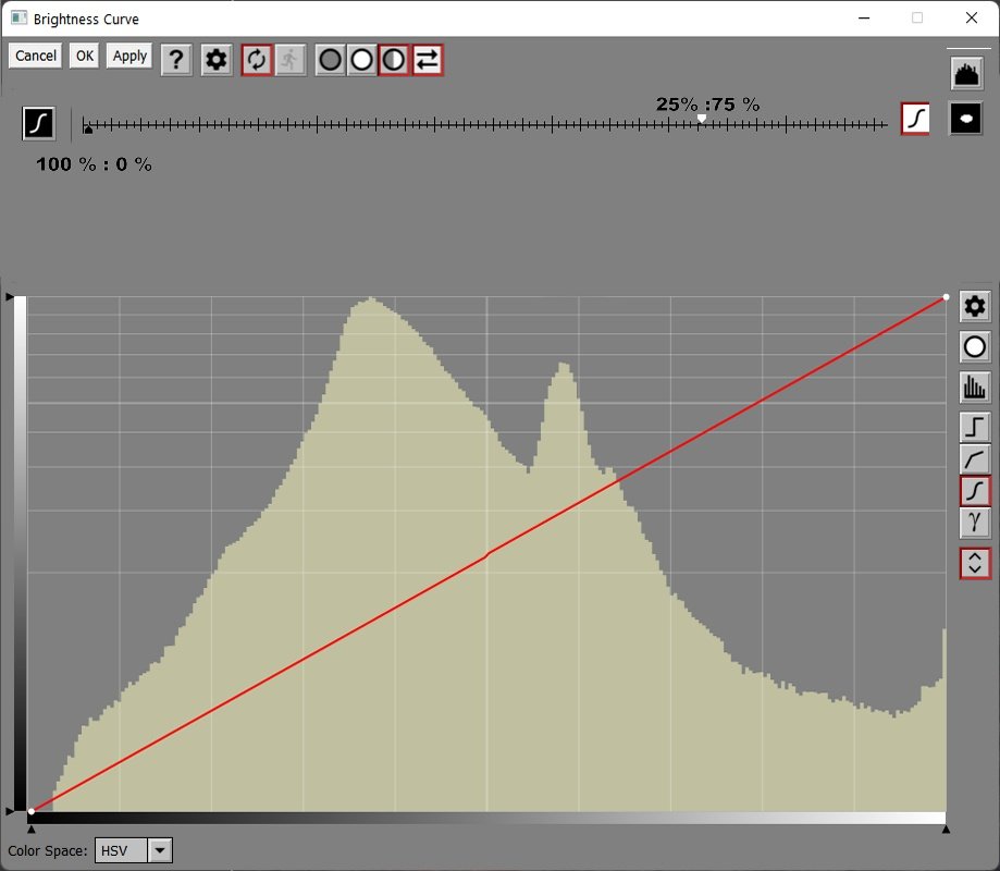

You will find below a suggested interface for the brightness curve controls.
  • The black and the white curves are represented respectively to the left and to the right.
  • Each cursor also indicates two numbers representing the blending ratios for each curve.
  • The left number is the bending ratio for the black curve ; the right number is the blending ratio for the white curve.
2021-11-23 Suggested user interface for Brightness curve.jpg (61.13 KiB) Viewed 4143 times
