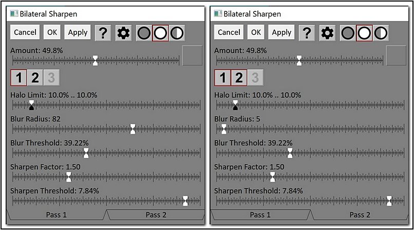

Bilateral Sharpen is my preferred method of adding local contrast or what DxO PhotoLab calls microcontrast. I usually apply after RL deconvolution sharpening at the raw stage (Raw Therapee) and sometimes a bit of Advanced Sharpening with a radius just under or equal to 1.
Screen captures show my default settings. They are not carefully worked out, just stumbled into them and I welcome criticism.
So I'll be happy to use the new method.

Along with the modifications to Bilateral Sharpen I am about to upload a new document that goes into considerable detail about how to get the most out of it. For example, I recommend the following changes to your settings for the large blur radius pass:
1) lower the blur threshold to 5-10%
2) Increase the Sharpen Factor to 2.0
3) reduce the Blur Threshold to 0%
I also usually set the Amount slider to 100%
