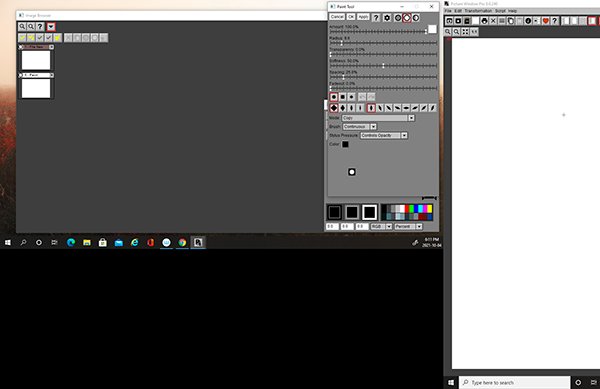

And, a minor issue on another topic - When using the Paint tool, it appears one cannot place a single click (eg to make a round/square solid shape). You must click two times before the mark appears. Placing a line seems to work, but not single click.

Single shot painting seems to work OK here using the mouse -- are you trying to paint with the tablet?

And, no, I was not using a tablet. I used the mouse and the first click does not register. Every single click after that (during that operation) shows immediately.

Can you post a screen shot of the Paint dialog box so I can see what settings you are using?

I grabbed a screenshot and while doing so, I thought about your comment regarding painting with a tablet. I noticed that the Stylus Pressure shows (default?) "Controls Opacity". I changed this to "Ignore" and was able to paint on the first click. Returning to the prior setting, again requires two clicks. And this was while using the mouse.
