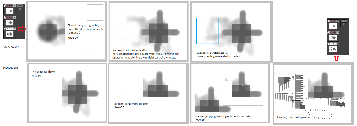

I have added some more images.
The are two scenarios.
In scenario one I only cloned away part of the image and used some Undo/Redo
In scenario two I first cloned something away, copied the rest and then undid last operation.
If I couId guess the problem is only in Clone. Paint has nothing to do with it.
I remember that when I was working with the original image I was trying to copy the top of a church tower behing battlements and make it a bit hazy or vague. That needed a lot of switching between Copy and Paint, undoing and redoing until I overcomplicated it. I did not like the result anyway and threw it away.
I did not report it at that time because with that many repeated steps and clicking I would not be able to provide any sensible description or a clue.

Re: Paint Amount control recalculation
Thanks, I am able to reproduce the problem here, and I think I have found the source of the problem.

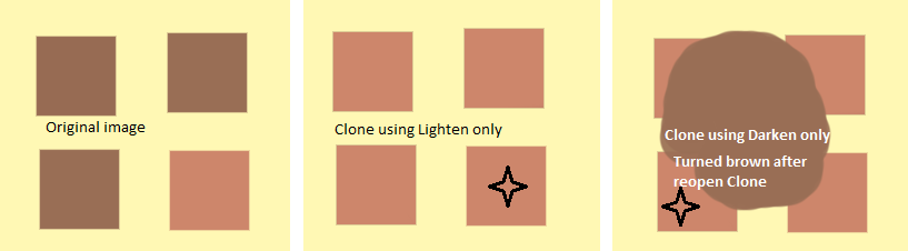

There is one more thing I have discovered.
The second image shows the result after I used Clone in Lighten only mode sourcing the lower right square and clicked OK.
The third image shows the result after I reopened the second image, used Clone in Darken only mode sourcing the lower left square (now light brown), clicked OK and reopened the transformation.
Apparently the probe sourced the original brown color instead of the new light brown. It looks as if the light brown color was not saved though it was visible covering the brown.
I think these are all different manifestations of the same bug.
