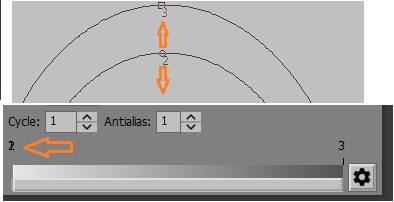

This is about newly added control points not the default ones.
Oval gradient:
1. Put a new control point between the starting and endig points of the gradient bar.
2. Double-click on the new or the ending (rightmost) control point on the bar to display its color picker.
3. Drag the new added control point in the preview window up or down -> the preview is recalculated and the point jumps to the center point of the gradient preview, and to the starting (leftmost) point on the bar gradient bar.
Linear gradient:
With linear gradient when you drag the new control point up or down, it jumps to either of the default points depending on the direction.
When you display color picker of the starting (leftmost) control point in the step 2., then dragging the new point in the preview recalulates the preview but the point stays put and the gradient does not change.
I have not tried the other two gradient types.
Dragging gradient control point with color picker open
- gradient point jumps.png (7.07 KiB) Viewed 2928 times

FYI, to select a color for the color line, you need to click the eyedropper button in the color picker -- otherwise dragging a gradient control point repositions it. There was a problem with this latter operation when a color picker was open.

I am aware of the probing functionality of the eyedropper.
The reason why I opened the color picker was to use its brightness slider to adjust the ending control point from black to gray. After that dragged the mid control point in the preview to reposition it accordingly.
