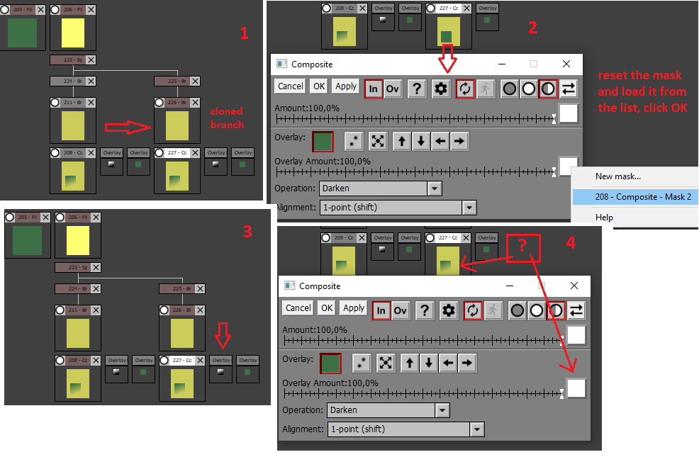

As it shows, the parent image is not necessary though I added Brighteness Curve for an ilustration.
Image 1
1. Create a branch with Composite, load an Overlay image, Create an Overlay mask (here gradient)
2. Clone the branch
Image 2
1. Reopen Composite, go to Overlay Amount, reset the mask
2. Load the same original mask from the list, click OK
Image 3
The cloned Composite displays the Overlay mask icon in the Browser
Image 4
1. Reopen the cloned Composite -> the Overlay Amount rectangle is empty and the Overlay mask icon gets removed from the Browser
2. Alternatively edit a parent transformation -> the Overlay mask icon gets removed from the Browser and after Composite is opened there is no mask in the Overlay Amount rectangle.
An interesting point is that though the mask is no longer there, its efect is still visible both in Composite thumbnail in the Browser and the preview window.
Once again, when you recreate a mask in the Image 2 step 2 instead of loading it, the mask stays put.

Image 1
2. Clone the branch
Image 2
Image 3
Image 4

Re: Composite overlay mask removed on reprocessing
Still not seeing the problem here. Are you using the latest version?

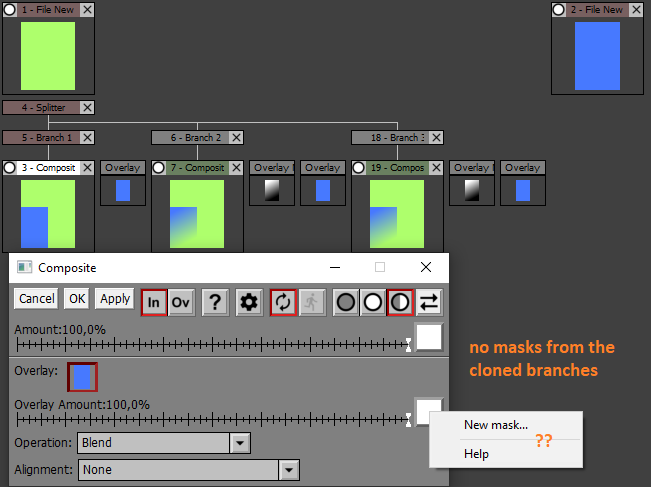

One more observation - a bit confusing, sorry for that:
(Not in the image)
1. Clone already cloned Composite (7) -> it gets cloned as 19 but without the mask - no mask thumbnail in the browser
2. Open Composite 19 and expand the Overlay Amount list -> there are two previous masks: 3 (original created as New) and 7 (cloned)
3a. load the original mask 3, click OK and reopen Composite 7 -> there are again two masks: 3 and 19, the first and the last
however
3b. if you load mask 7 (cloned) instead, click OK and then reopen Composite 7 -> there is only one mask: 3 (original), mask 19 (cloned) is missing even though its thumbail is visible in the browser.
The image shows another situation where the original Overlay mask (3) was first reset and then the list was expaned -> no mask from either of the cloned branches 7 or 19 is present even though their thumbails are visible in the browser.

(Not in the image)
however
