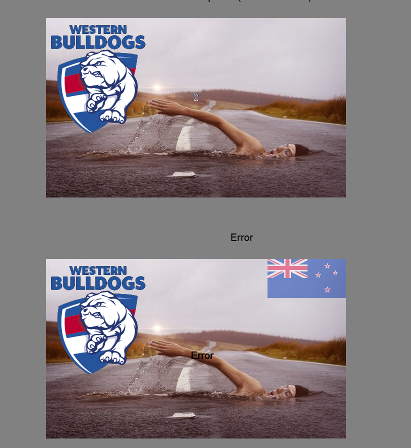

Also, when using the Shit-Ctrl mouse to move the overlay image around, I got an error message - I believe I tried to move the overlay image beyond the bounds of the Input Image.

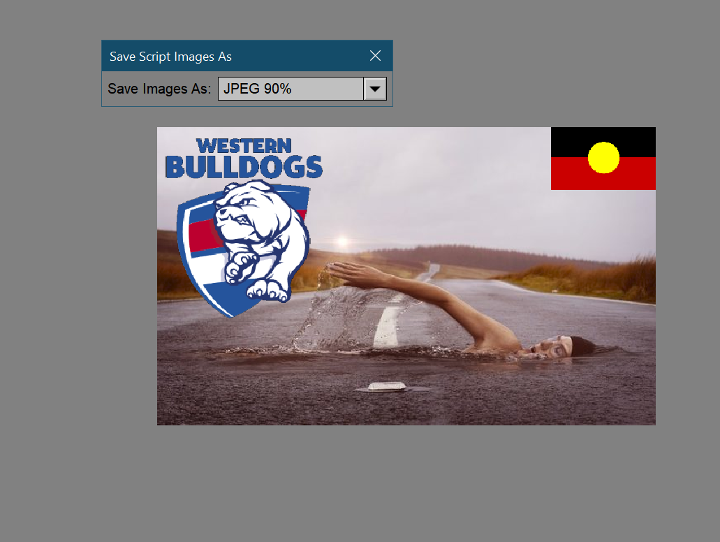

There is one more observation that came up when I was doing it. When I wanted to save Workspace Script with Image Copies, a popup window appeared asking for image format and/or JPG compression rate (which is great). Choosing the format and closing the popup, causes another popup to show up (with Uncompressed TIFF by default regardless of previous choice). I deduced that the popup windows are for each image in the workspace being saved in turn - but I didn't know which one, and also it took me a while to understand (correctly?) that this is what's happening.

Under File Preferences, you can set the file type via the Save Script Images As setting. For the next release, if Save Script Images As is set to Ask, the popup dialog box has the name of the transformation in its title bar so you know which image it is asking about.
I tried to produce an error by moving the overlay image outside the input image in Composite but was unable to reproduce the problem. From the screen shot, it looks like the problem was that the two control points were coincident which would otherwise cause a divide by zero in the mapping.

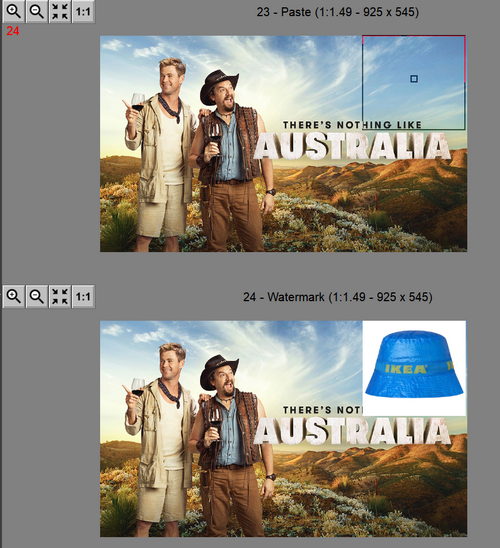

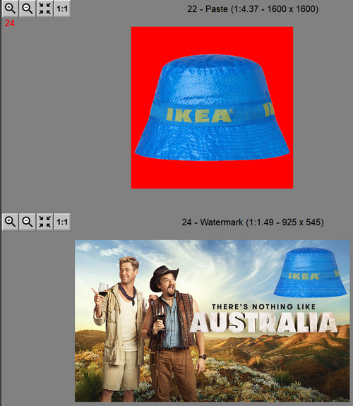

I've been playing with Watermark for the same purpose - placing a logo or another image on the Input image. Please see the two screenshots.
I can position the 'logo' easily if there is no mask. But if there is a mask, I don't know how to do that anymore.

To get the input image back, click on the Watermark thumbnail in the image browser. To get the watermark image back, click on its small thumbnail next to the Watermark thumbnail.
For the next release, I am reworking several of the transformations like Watermark to have something similar to the In/Ov buttons in Composite to make it easier to switch which input image is displayed.
