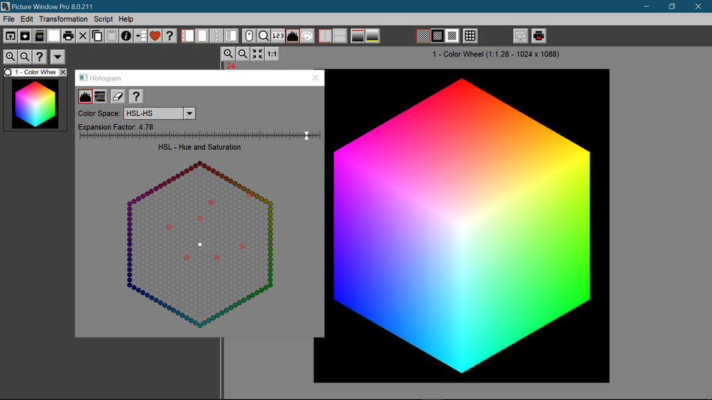

I was trying to understand better how the 2D histograms work by trying them on the Colour Hexagon test image. I think I understand how the HSV-HV operates, but I'm having trouble wrapping my brain around the HSL-HS one. In HSL-HS histogram, all the colours in the Hexagon are the surface of the upper cone - i.e. fully saturated regardless of Lightness. But why probing on them shows red marks for less saturated colours? Is it because the probe registers H and S of the point and sets L to 50%?

Yes, the probe was not working correctly for HSL-HS. Fixed for next release.

Also, and I understand it's a synthetic image with only saturated colours, if the expansion factor is left at 1, the colours of 'dots' on the 2D histograms are almost black. I would expect that if there was some colour peak that would dwarf all the others, but shouldn't they have been all about equal?

There is a single, very large spike in the histogram corresponding to the black background. This shows up as a white dot in the center of the hs histogram.

Ah, thank you.
