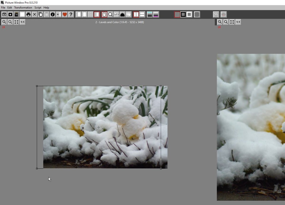

I'm not exactly sure what I'm doing wrong (or if I'm expecting the right thing). Here is screenshot of Shrink Crop Box to the Current View - what I was thinking that it would set the crop box based on input preview, but it doesn't seem to work this way - it seems that if the input image preview is zoomed in, the Shrink... works fine horizontally, but it's off vertically (I can explain it better if it doesn't show this way).
Posts: 4884
Re: New Crop
OK, thanks -- I fixed it for the next release.

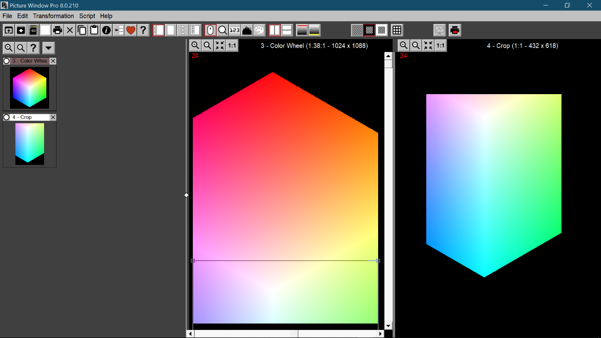

Not sure if this is related, but I notice if I drag the crop selection in to the image, and then drag the bottom edge down, the selection box extends beyond the image boundary.
It snaps back into place with any additional positioning.
Posts: 4884
Re: New Crop
I fixed the out of bounds problem for the next release. Also, to get the output image to update when dragged, I now update the output image if you stop dragging it for 0.25 seconds. This lets you move it around freely and then pause to check the result.
