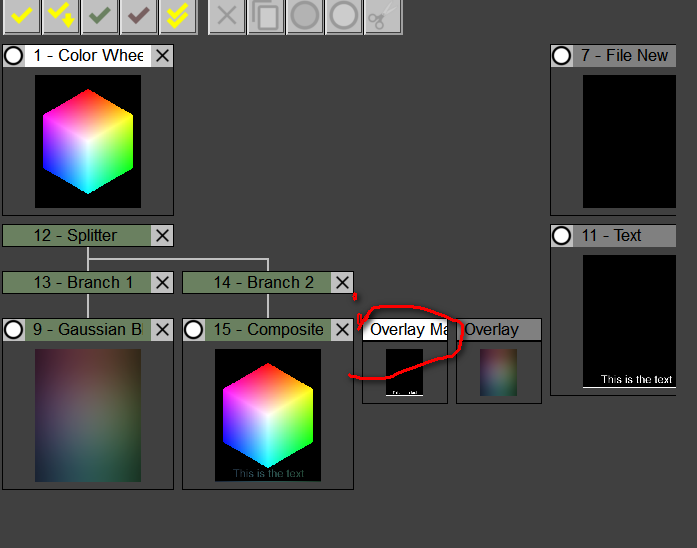

The white highlight on the header of Overlay Mask thumbnail is always white - should it?
Posts: 4884
Re: Adaptive colour for fonts
Fixed for next release -- it is supposed to be highlighted when the corresponding Mask dialog box is open and un-highlighted when you close the Mask dialog box is closed, but the latter was not happening.
