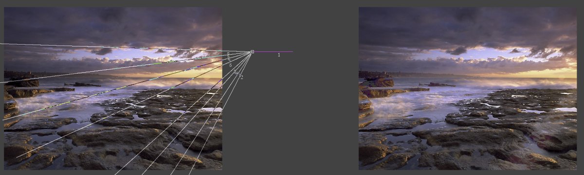

If you are trying to simulate crepuscular rays, I suggest using the Gradient/Sweep transformation instead of a mask. I have attached a workspace script with a sample of how to do this -- when you open the script, just supply the name of the image you want to apply it to. You can adjust the Amount and locations of the rays by editing the Sweep Gradient transformation. When working on the color line, it may be useful to widen the dialog box to give yourself more working room. You can also drag the radial lines to reposition them although you can't drag one past another.

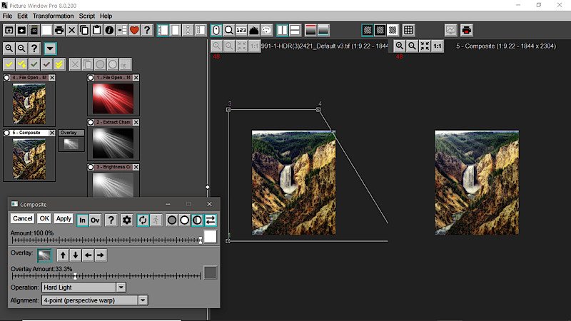

...For beams or rays, I will:
1) Take a beam sky/cloud image from my library that I have accumulated over the years [or search the internet for a free image of preference] and extract its Luminance channel.
2) Change this image's contrast about a 50% gray tone Luminance to preference.
3) then Composite-Hard Light or Soft Light blend with a 4 pt Perspective alignment; adjusting points and Overlay amount to preference where the image to be beamed is the Input.
With this workflow, it is easy to change the 2) contrast; the amount applied to the desired image; and adjust the shape and location of the beams. .

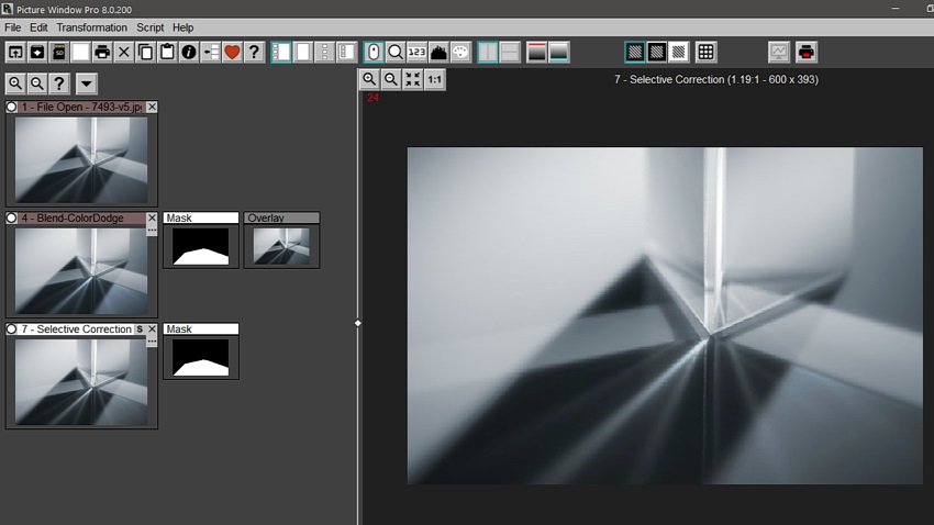

Blend-ColorDodge with an image area mask of the foreground rays could be used to increase their contrast; followed with Selective Correct to decrease/darken a Cyan color cast... .

Another possibility to prevent a strong cyan color cast that the Blend-ColorDodge creates is to Extract the original image into its H, S, and V channels; perform the Blend-ColorDodge step on the V channel with an image area mask of the foreground rays; then re-Combine the H and S channels with the modified V channel... .
It is not clear to me what is intended with the lower right portion of the image so I included it in the image area mask. For illustration, the Amount of the Blend-ColorDodge was set at 100% which may be too much.
