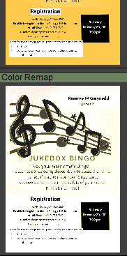

Hello. Creating a flyer & converting to gray scale. (it is actually still a color image, but I changed most of yellow to white with remap transform.)
Screenshot 2021-01-11.png (54.3 KiB) Viewed 4166 times
There are three text boxes at bottom of the line, arrow transform: the top & bottom have text background = white; the middle has text background = yellow. The text boxes overlay the image, so I would expect the middle TB to have the yellow background on the remap transform, but it is white.
I see that the transforms may be reversed - if I move the color map above the line, arrow transform, then the TB colors are correct. But the TB background color should apply in both positions.
Thank you, Bob

I think I understand your post, but I may have it wrong. My understanding is that you have two transformations -- Lines, Arrow Text followed by Color Remap. From the screen shot, it looks like the middle text background color is a slightly different yellow from the overall background, gut it is hard to tell.
First Lines, Arrow Text paint the center text box with black text and a yellow background. Next, Color Remap changes the yellow text background to white, and since the overall background is a slightly different color and does not match exactly it turns into a light yellow. This is what I would expect since Color Remap is just acting on its input image, of which the text background.
If you reverse the order of the two transformations, Color Remap first changes the overall background color to light yellow and then Lines, Arrow Text paints a black text on a yellow background, which accounts for the different end result.
