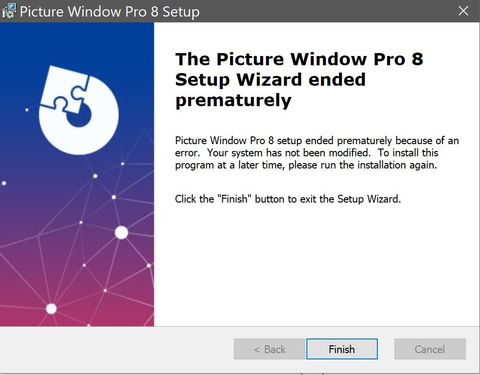

The last several updates gave me an install problems, after Microsoft pushed my Windows 10 from 1903 to 2004. The screenshot shows the report of failure. At first I could just start the .msi file again, and it would work. I might need two tries.
