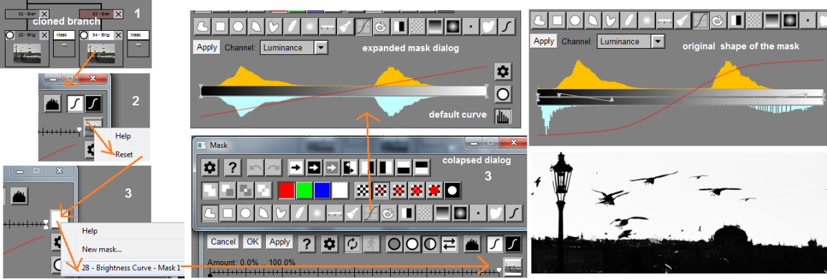

Sorry for not enough clarity. Please see the attached image.
If I understand it well, the mask reloaded in step 3 (No. 28) is the one from the other (original) branch. The mask reset in step 2 (cloned branch mask) no longer exists.
The the upper right image shows the shape of the mask curve of the original image. I would expect the mask curve loaded in step 3 in the cloned branch (upper middle image) to have the same shape as it is in fact the same mask - both are the mask number 28.
The lower right image show part of the mask displayed in both branches. The mask curve in the upper middle image either should display no mask or should have the shape like the curve on the right.

When you select a mask from the amount menu you get a snapshot of the current mask image which is in turn used to initialize the new mask, not a copy of all the mask operations. This is just like starting a mask off with a copy of some other black and white image of the correct size that you opened from an image file. When you update the original mask, the changes propagate to all the transformations that imported it. If you reset the original mask, the copy is also reset.
When you clone or copy a transformation that has a mask, you get an identical copy of the transformation including all the mask operations. The cloned mask is independent of the original mask and changes to the original mask do not propagate to the new mask.
