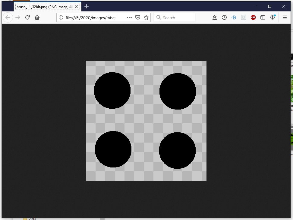

When I open a PNG in Firefox, this is what I see: I didn't think the checkered background would be visible?
Posts: 4908
Re: PNG question
The checkerboard is not actually part of the image -- it is just a convention Adobe started in Photoshop to indicate the image is transparent by displaying an artificial background behind the image. If you open it in Chrome you don't see the checkerboard. If you include the image as part of a web page however you should the the page background behind the image where it is transparent. This is the primary use for transparent PNG files.
The file definitely has 32 bits per pixel. It is written with bit_depth = 8 and type = PNG_COLOR_TYPE_RGB_ALPHA.
If you are saving a 48-bit color image, the PNG will be 64-bit with bit_depth = 16, so that may be the issue.
