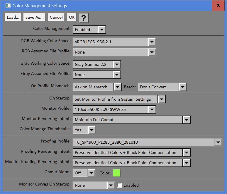

There seemes still to be a problem, at least on my system:
My colormanagement settings:

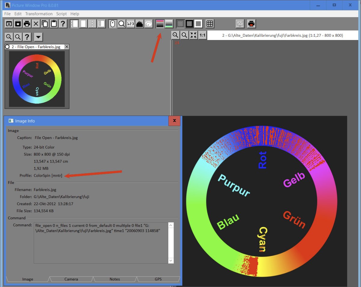

My test with the Farbkreis.jpg, containing the ColorSpin-profil.
I opened without converting to my working space profile.
The thumnail is colormanaged.
The main image after pressing the highligt buttom not colormanaged.

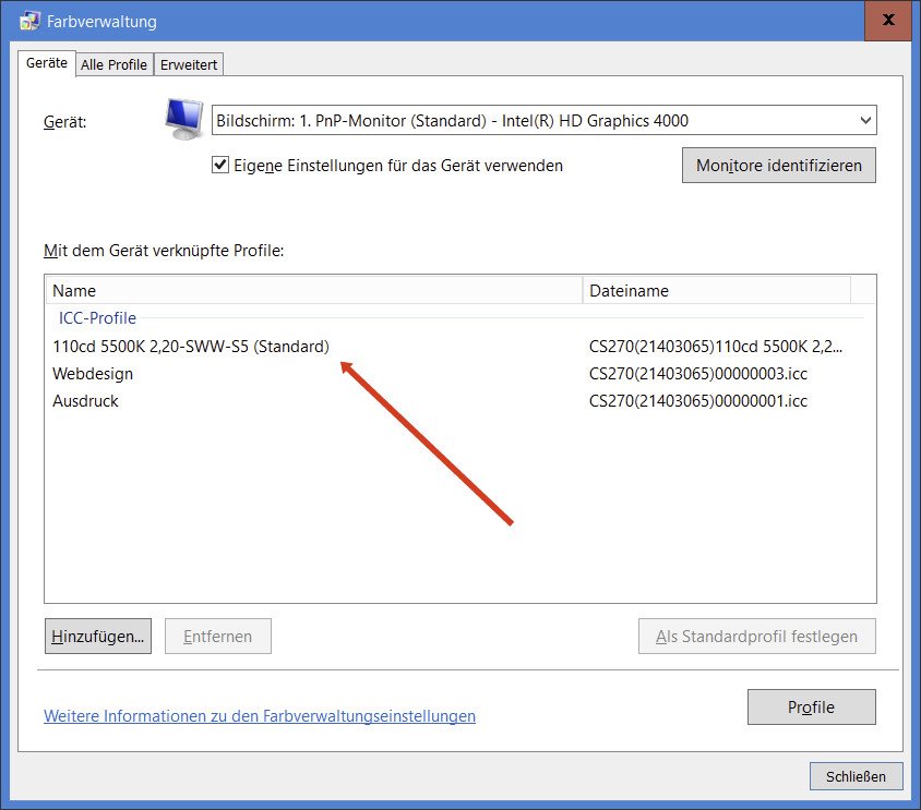

and here the Windows settings:
Posts: 4883
Re: Update Available - Version 8.0.81
Got it, thanks.
