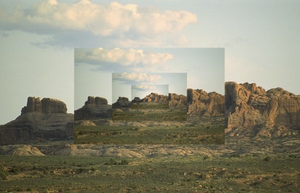

I was experimenting with an image being resized multiple times to make it progressively smaller, then compositing each smaller image over the next larger size (almost like looking into two mirrors opposite each other), but found the grid method quite cumbersome and the Layout required multiple different settings, even when using Reload last settings, although the center horizontally and vertically buttons in Layout made centering a breeze.

I was able to make a composite of this type by repeatedly compositing images using 2 point (shift/rotate/scale) alignment and placing each successive image into a smaller a smaller rectangle in the center of the image, using a grid for guidelines. The advantage of this method is that you can replace the overlay image with a different one and it still works the same way.
